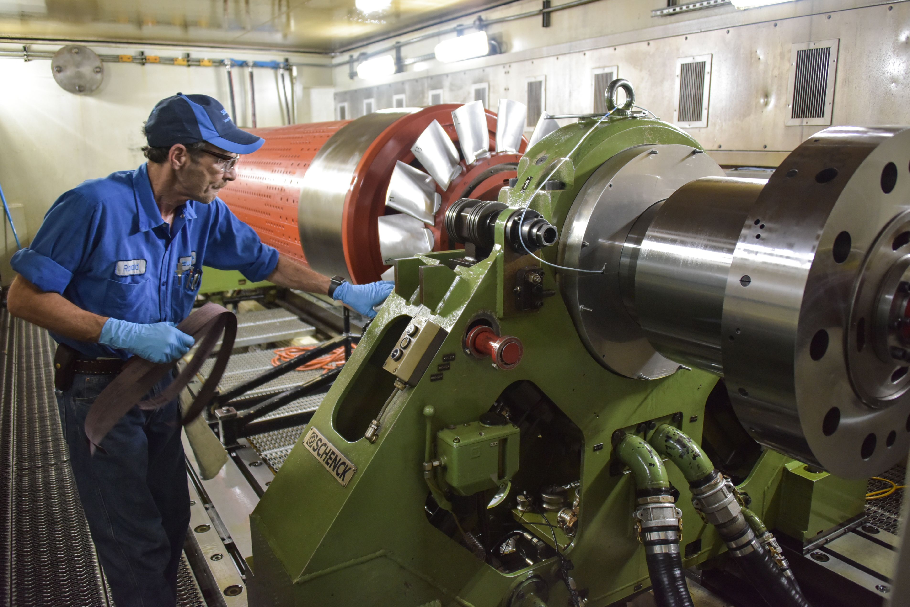

The perfect balance for large rotors
The installation minimizes the time required to balance a rotor and the latest upgrade will reduce that time even further.[/caption]
Electrical generators are vital to creating the electricity we all use in our everyday lives. With increasing demand, reliable performance is essential to minimize the risk of blackouts. High-speed balancing facilities are used to ensure optimum performance of large pieces of rotating equipment, such as steam or gas turbines. Sulzer, fluid engineering company specializing in pumping, agitation, mixing, separation and application technologies, operates two of the very few independent facilities in the world, including a site in Texas that recently underwent an upgrade project to improve both its flexibility and efficiency.
The independent, high-speed balancing facility in La Porte, Texas, is a specialist piece of diagnostic equipment that is designed to test some of the largest turbine rotors in the world. Equipped with a vacuum chamber, it can run complete turbine rotor assemblies at full operating speed, and beyond if necessary. The installation minimizes the time required to balance a rotor and the latest upgrade will reduce that time even further.
The bunker itself is designed to accommodate turbomachinery up to 30 feet (9 meters) in length, 8.5 feet (2.59 meters) in diameter, and up to 50,000 lbs (23 tons) in weight to speeds up to 40,000 rpm. Vibration diagnostics are used to analyze the radial vibration at the bearings to ensure that the best balance is achieved at operating speed as well as minimizing the deflection and vibration amplitudes during ramp up and coast down.
