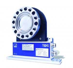

Figure 1. HBM’s new T40HS high-speed in-line bearingless torque sensor
Over the last twenty years, bearingless in-line torque sensors (Figure 1) have become the standard for in-line torque measurement. A bearingless design allows for greater accuracy, higher RPM capability, and 24/7 operation with little or no sensor maintenance. A combination of digital telemetry and digital electronics helps to reduce noise, increase resolution and improve torque sensor performance. The use of titanium rotors allows for design of in-line bearingless torque sensors capable of up to 45,000 RPM. This is well above the capabilities of a typical strain gauge-based torque sensor but is necessary for applications like turbine fan blade testing.
Today, custom torque sensor designs are helping to meet the growing demand for instrumentation suitable for characterizing high-horsepower turbine engines, with sensors capable of measuring torque greater than one meganewton meter (1MNm) now available. Most bearingless torque sensors use foil-strain gauges as the means of measuring stress. They are configured and wired in what is known as a Wheatstone bridge.
A voltage (preferably an AC voltage to improve noise immunity) is applied to the circuit. This is known as an AC carrier frequency amplifier. When the sensor experiences mechanical torque, the resistance of the Wheatstone bridge changes and produces an analog voltage that is proportional to the torque applied. As the rotor and stator are not in physical contact with each other, the analog voltage on the rotor is converted to a digital signal, which is then sent to the stator via a digital telemetry system. There are two antennas, one on the rotor that spins and one on the stator that is stationary. The stator receives the digital signal and converts it into any one of a number of usable outputs. This method of measuring torque is accurate and repeatable. However, there are limitations as to how fast the electronic parts can spin. Some bearingless torque sensors can also measure RPMs or angle of rotation with a reference pulse.

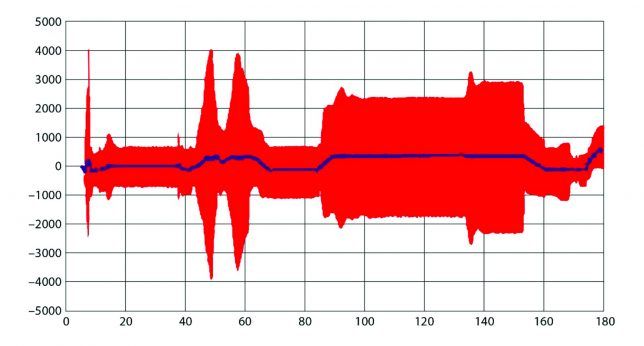

Another way of determining torque on a test stand (reaction torque method mentioned previously) is the use of a lever arm and force sensor. As Newton's third law of motion explains, for every action there is an equal and opposite reaction. If the shaft is turning clockwise, there is an equal force (reaction torque) that wants to turn counter-clockwise. Figure 2 shows the contrast between torque data acquired using a lever arm and force sensor (blue line) and the dynamic data acquired by an in-line torque sensor (red waveform). The mass of the dynamometer acts as a 20Hz low-pass filter, generating what could be called an average torque.
Figure 2. In-line torque sensors offer a more dynamic torque output than reaction torque methods (load cell and lever arm)[/caption]
Dynamic data offers engineers more in-depth information on what is actually happening with the device under test. Comparing dynamic signatures after design changes are implemented gauges their effect on product performance and efficiency. When implementing a bearingless torque sensor, especially at higher RPMs, keeping the unsupported driveline as short as possible helps reduce the risk of hitting a critical speed, i.e., the point at which a rotating shaft becomes unstable (begins to vibrate harmonically). The goal is to avoid unwanted vibrations and shaft run-out, which can increase measurement uncertainty, as well as posing the potential for a catastrophic failure of the driveline. If the driveline is short and stiff enough, there might be no need for a support bearing. Keeping most of the weight near the bearing of the power absorber reduces the sag in the driveline.
