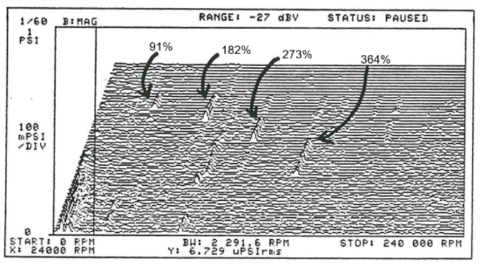

  3. Gathering and understanding data: frequency, trends, and vibration data
  4. Conduct a review of data and review operator logs
  5. Plot raw data to look for “strange” trends
  6. Waterfall diagrams (shown in figure below)
  7. Compare data to the original test stand results
