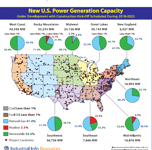

Power development plans show renewable and gas-fired generation are virtually the only types of power plants the industry plans to build over the 2018-2022 period. On a national basis, renewable energy projects are expected to account for 56.7% of all new power plants build over the next five years. Gas-fired generation will account for 42.3% of all power-plant construction starts between now and 2022 (Figure).
Nuclear and coal, by contrast, amount to slightly less than 1% of all new-build power projects scheduled to begin construction between 2018 and 2022. That number may fall even further. Plans to build two new units at the Virgil C. Summer Nuclear Power Station have been abandoned. And the troubled Kemper County Integrated Gasification Combined Cycle (IGCC) plant in Mississippi has been ordered to stop gasifying lignite and instead burn only natural gas.
Across the nation, the regions with the largest proportion of renewable power plants scheduled to begin construction between 2018 and 2022 are the Midwest, the Rocky Mountains, New England and the Mid-Atlantic. The Southeast, Northeast, Great Lakes and Southwest regions will see lower percentages of renewable energy projects during the next five years.
Between now and 2022, the regions where gas-fired new construction is expected to dominate are the Northeast, Southeast, Great Lakes and Southwest. Whatever their fuel type, though, there are fewer central station power plants scheduled to be built in the near future than has been the case in prior years.

Renewables outlook
The rush to renewables, underway for over a decade, continues to change the face of the power generation business. Over the next five years, developers should begin construction on about 118,900 MW of renewable energy projects, amounting for about 56.7% of all new generation projects during this period.
On a percentage basis, the Midwest, Rocky Mountains, New England and Mid-Atlantic regions should see the most activity. The Midwest expects to see 21,637 MW of renewable energy projects kicking off construction between 2018 and 2022.
The Rocky Mountain area will go even greener, with 25,134 MW. The Mid-Atlantic region plans on slightly less than 9,000 MW, while New England expects to see slightly more than 4,000 MW of new renewable generation begin construction during this time.
Other regions like the Southwest, the West Coast and the Great Lakes have more renewable projects kicking off on a MW basis than the Mid-Atlantic and New England regions. But on a percentage basis, those three regions trail the Mid-Atlantic and New England.
