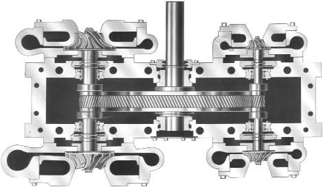

Integrally geared compressors were first introduced for plant and instrument air service in the 1960s. The term “integrally geared compressor” (IGC) refers to a large driving gear (bull gear) which is coupled to a driver. The bull gear and up to six driven pinions are located in a suitable gear case. Pinion ends protrude through the gear case and impellers are fitted at the end of each pinion. In turn, each impeller is surrounded by its own flanged-on compressor housing (Figure).

To be clear, integrally geared technology allows speed optimization by simply designing and incorporating different impeller diameters to fit on the pinions driven by the central or bull gear. The different impellers (each called a stage) are typically three-dimensional, semi-open style.
Up to six pinions can be driven by the bull gear and impellers can be fitted to each end of a particular pinion. Because each pinion can have a different number of teeth compared to the number of teeth on another pinion, up to six different driven speeds can be accommodated in an integrally geared process gas compressor.
Impellers are designed and then machined on multi-axis machines to optimize blade contours, angles of twist, blade overlap, number of blades, and so on. One can, by design, optimize the efficiency of any of the 3-to-12 impellers. The various impellers are usually attached two per pinion. A wide range of impeller attachment methods is feasible and replacement and upgrading is relatively simple.
A single bull gear engages several pinions and each pinion can have a number of teeth that differs from the number of teeth in the other pinions. Therefore, up to six impeller speeds can be found in a single modern IGC compressor. Accordingly, the overall arrangement of integrally geared air and process gas compressors allows the use of the most efficient impeller for each of the up to six speeds and up to 12 compression stages that can be accommodated in modern IGCs.
Figure: Semi-open impellers are attached two per pinion; a bull gear engages up to 6 pinions (= 12 stages) in modern integrally geared compressors. Two pinions are shown here (Source: Cameron Compression, Buffalo, NY)[/caption]
