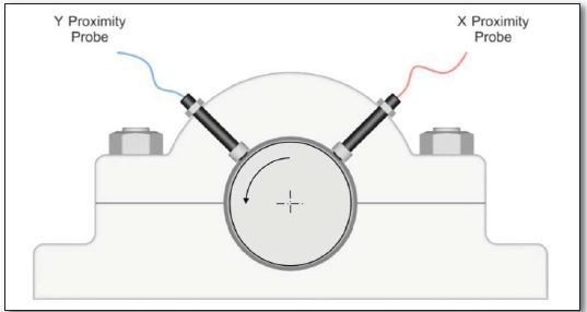

Shaft vibration measurements relative to the bearing are made possible by pairs of radial- mounted, non-contact proximity transducers installed in an X-Y configuration 90 degrees apart at each bearing location (Figure 1). Because the frequency range of proximity transducers starts at DC (0 Hz), the information from each X-Y probe pair enables two-dimensional views of shaft dynamic motion and average position within the bearing clearance.

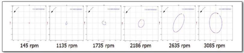

The shaft orbit presentation is constructed by plotting the AC vibration signals from each probe pair together in X-Y format. The resulting graph in displacement units represents the dynamic deflection of the vibrating shaft within the bearing. One way to conceptualize how a shaft orbit develops is to first consider a shaft rotating at low speeds with little dynamic motion.
At low speeds, the resulting orbit presentation will not be much more than a dot on the graph, assuming that the shaft is straight and there is little noise in the signal from scratches or other surface irregularities.
Then, consider the same rotating shaft with the introduction of increased unbalance force at higher speeds. The shaft will now begin to exhibit dynamic response as a result of the unbalance force. Because unbalance is an outward force that is also rotating at the rpm of the machine, shaft deflection will tend to follow a circular path at a frequency equal to running speed (Figure 2).
