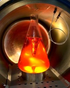

The Turbine Oil Performance Prediction (TOPP) test helps users evaluate different formulations and to make better purchasing decisions. The purpose of the test is to stress new turbine oils in an accelerated way to measure any physical changes to the fluid. One of the most common failure modes of in-service turbine oils is deposit formation (sludge and varnish). The most common reason for changing a turbine oil is antioxidant depletion (sometimes measured as oxidative stability). Clearly, these are two important parameters to measure and compare in this stress test.
The TOPP stresses an oil at 120C with an iron catalyst for 4-6 weeks. Each week, tests are drawn to measure oxidation, antioxidant health and varnish potential. This is a cost-effective procedure performed by most labs. There is a wide range of performance variances in the TOPP test and observations reveal that these have some correlation to field performance as well.
When this test was first performed, there were several performance differences. In one case, a turbine oil touted to be "varnish-free" completely fell apart and generated a high amount of deposits during the test.
