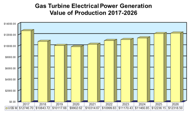

In its 2017-2026 worldwide market analysis of gas turbine-powered electrical generation, Forecast International projects that revenues over this period will total $112.11 billion, an increase of 6.6% over the comparable figure for the period 2016 to 2025. This increase shows that the utility and industrial power generation market will continue to provide a strong stimulus for production of gas turbines (GTs) in the long term (Figure 1).
But emphasis on reducing resource consumption and emissions (especially in Europe) has resulted in great support for renewable resources. In some areas, heavy subsidies are causing conventional power generators to operate at a loss.
In Germany, for example, new simple cycle facilities have been mothballed upon completion without ever generating a watt of power. In the longer term, increasing power demand will open these mothballed plants. This is contributing to a medium-term dip in demand. In effect, this reserve capacity is limiting additional procurement.
Many of these simple cycle GT plants are new and virtually unused, while others have very few hours on their maintenance records. Major increases in operating economics can be obtained by modernizing them for combined cycle operation by the addition of heat recovery steam generators (HRSGs) and steam turbines (STs).

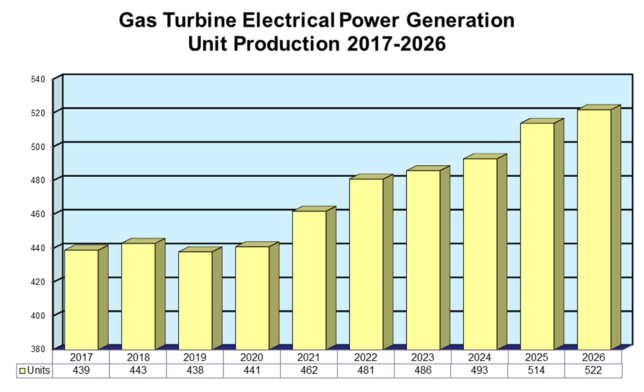

Small turbinesThe prognosis for gas turbines unit sales shows some promise in the long term. However, several more years of flat or declining sales are predicted before any recovery begins. Our market analysis of GT-powered electrical generation projects that between 2017 and 2026, worldwide sales of GTs for electrical power production will total 4,719 machines.
The market for smaller turbines has been taking a serious hit due to several factors. In some cases, numerous smaller units are being replaced by one or more large units. In addition, small GTs are losing ground to gas-burning reciprocating engines.
Recips can now match the power output of small GTs, but operate at greater efficiency. Small GTs have an edge over recips in urban areas in terms of reduced noise and vibration.
Machines in the 3 to 10 MW are projected to account for just less than a third of total GT unit production. Those smaller than that are experiencing low unit sales.
The 10 to 20 MW sector should see less than 5% of unit sales. The second-best category of unit sales is 20 to 50 MW with 31%. This is up from 17% only four years ago.
Much of this gain has come at the expense of the 0.2 to 3 MW grouping which has fallen in that time from 21% to less than 2%. Once again, we see the strength of aeroderivatives and the decline of the bottom end of the GT market.

Global trendsIt is apparent that a 6.6% revenue increase in GT sales (compared to last year’s forecast) is significantly less than the rate of electric power demand. Global electricity demand is projected to increase by about 85% as living standards rise, economies expand, and the electrification of society continues. About half of the projected growth will come from the industrial sector. Its share is expected to rise as advanced manufacturing, automation and control technologies transform the sector.
Strong growth also will be seen in the residential and commercial sectors as rising living standards generate electricity consumption. A good portion of the growth in electricity demand through 2040 will come from economies gaining access to electricity for the first time. The International Energy Agency (IEA) estimates that by 2030, an additional 1.7 billion people will gain access to electricity. The number who lack electricity will drop from 1.3 billion to just under 1 billion.
Despite steadily increasing demand for electricity, projected sales in the number of GTs over the coming 10-year period will decline steadily. This is taking place at the same time as the cost per unit rises due to a shift toward higher-output turbines.
Power generation GTs operate in an unusually complex market environment. Improvements in the monitoring of power production and the emergence of energy storage enable more precise matching of available generating capacity to total power demand on a real-time basis. This facilitates optimum procurement of the assets required to meet demand.
Meanwhile, the average output of individual GTs has risen. Thus additional power can be met by fewer units. Two decades ago, a typical industrial GT plant might deliver about 800 MW.
This would be split between four 200 MW units. Today, 1.9 GW units are available. This is a big reason why a jump in electricity demand will not translate into unit sales. These mega-turbines deliver significantly greater power per dollar of capital investment than smaller units.
