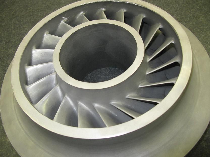

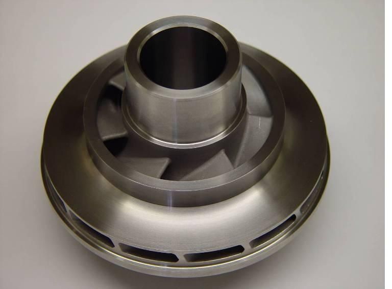

The cost of components made by PM HIP is generally higher than the same products made by HW. However, small batches of complex products produced by PM HIP are economically feasible compared to HW (Figures 1A & B).
Figure 1A: Impeller made by PM HIP from Ti-6Al-4V alloy powder (A) (Source: LNT PM).[/caption]
Figure 1B: Gas compressor impeller made by PM HIP from Inconel alloy 625M powder.

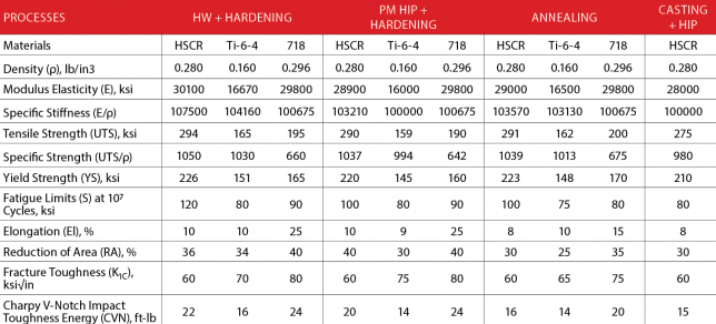

Table 1: Mechanical properties of HSCR steel, Ti-6Al-4V alloy, and Inconel alloy 718 made by four different processes.[/caption]

The various processes used produce different mechanical properties (Figure 2). A variety of techniques are employed, depending on the material. HW + hardening of forged HSCR steel, for example, is accomplished by quenching, refrigerating, tempering, and finally air cooling. Forged Ti-6Al-4V alloy and Inconel alloy 718 are hardened by heat treatment.

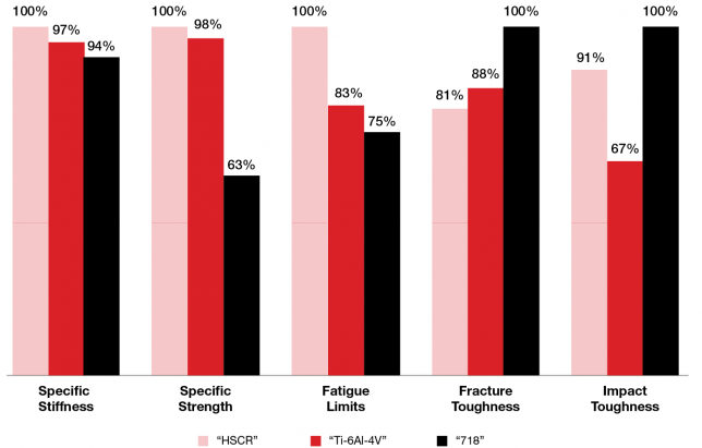

Figure 2: The room-temperature mechanical properties of HSCR steel, Ti-6Al-4V alloy and Inconel alloy 718.[/caption]
Figure 2 shows a comparison of the mechanical properties of vacuum melted, forged, and hardened HSCR steel, Ti-6Al-4V alloy, and Inconel alloy 718. HSCR steel possesses higher specific stiffness (E/ρ) and specific strength (UTS/ρ), higher fatigue limits (S), lower fracture toughness (K1c) and higher impact toughness (CVN) compared to Ti-6Al-4V alloy. Additionally, HSCR steel has a higher elevated temperature strength up to 950°F compared to Inconel alloy 718 and a higher elevated temperature strength up to 1200°F compared to Ti-6Al-4V alloy.
HSCR steel also has greater workability and machinability, and better wear resistance. Alloy 718 and Ti-6Al-4V alloy have better corrosion and oxidation resistance compared to HSCR steel; but HSCR steel has no rust after a salt spray test (ASTM B117 using a 5% NaCl concentration, natural pH, at 95°F, for 200 hours).
Given its mechanical properties, critical components made by HW, PM HIP, and AM processes from Ti-6Al-4V alloy and alloy 718 can be replaced by HSCR steel without sacrificing stiffness, durability or lifetime (Table 1).
