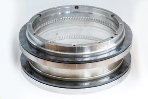

John Crane, a global leader in rotating equipment solutions, today launched its latest gas seal technology designed to be retrofitted into centrifugal compressors with oil seals to significantly lower operating costs, improve reliability and reduce methane emissions by up to 95 percent.
The Aura™ 120 Narrow Section gas seal enables the latest John Crane gas seal technology to be fitted into a larger percentage of older equipment, bringing with it the benefits of non-contacting design. Gas seal technology eliminates the need for oil lubrication associated with contacting seals and the resulting need to address harmful emissions entrapped in the oil. In the natural gas sector, centrifugal compressors equipped with oil seal technology are generally acknowledged as the leading source of methane emissions offshore and the fourth most significant onshore.
