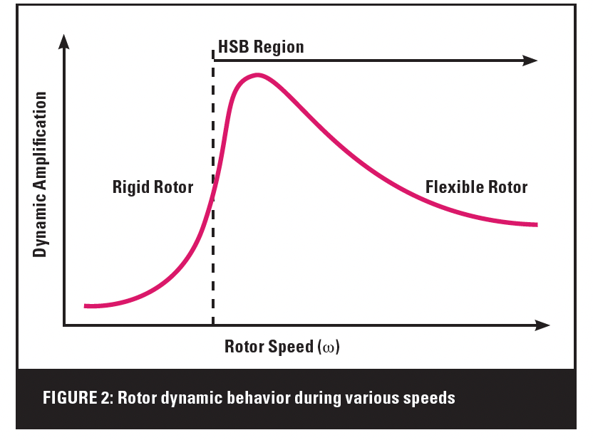

Rotors in turbomachinery are typically classified as either rigid or flexible. Rigid rotors do not show significant bending at operating speeds, while flexible rotors do, often operating above their critical speeds. Balancing is essential to minimize imbalance-induced vibration, especially in high-speed systems. A common question in the industry arises: If a rotor operates above its critical speed, is high-speed balancing always required?

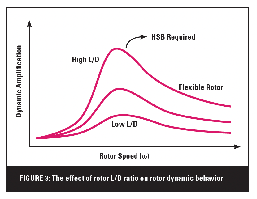

  • Dynamic amplification: If the amplification factor at operating speed is low, even flexible rotors may not require HSB.

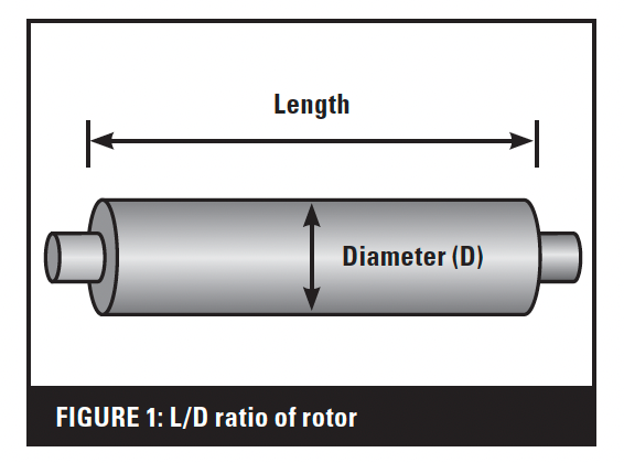

  • L/D ratio: Higher Rotor length-to-diameter ratio values (FIGURE 1) suggest flexibility but are not alone sufficient (FIGURE 2).
