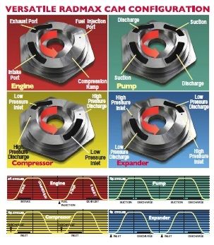

At the heart of the RadMax expander is a cam. Changing the cam profile along with intake or exhaust port locations, the the RadMax device can be turned into a compressor, expander, pump or an engine. In a pressure let down situation, typically, an expansion or throttle valve leads to a change in internal energy but no useful work is done. The RadMax device is a positive displacement expander that converts the pressure energy into useful work. High internal expansion ratios are claimed up to 20:1 to enable direct coupling to a generator.
