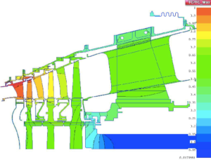

Two-dimensional (2D) thermal analysis was carried out to predict the thermal characteristics of turbine casings, vanes, blades, and discs at rated conditions. It included steady-state peak temperature predictions for component creep stress analysis and thermal gradients at various transient steps for disc low cycle fatigue analysis. This was necessary to understand the impact of thermals on extended MTBO life.
3D finite element analysis (FEA) was used to predict accurate thermal characteristics of hot gas path components, hot gas path radial temperature profiles, and cooling flows. Temperature predictions and mechanical displacements were compared with test results before mechanical integrity assessments were conducted. A thermal model was run according to development test cycle engine conditions. Transient metal temperatures at various spatial locations were predicted (Figure). The effects of the radial inlet temperature profile are evident from the contour plot. The same 2D thermo-mechanical model was run at test conditions, and the predictions were compared with the test data.
It is also useful to compare: transient normalized metal temperatures for a standard cycle between actual test; the normalized metal temperature between test and prediction at the stage 1 casing; and the metal temperature contours for stage 1 vane assembly and the rotor assembly at full-load steady-state condition.

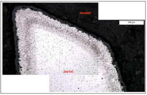

For wear assessment, a significant number of existing units were inspected, and existing overhaul reports reviewed. Evidence of minor wear damage was observed at the disc curvic engagement. To mitigate any risk of further damage due to wear, the tie bolt loading on the discs was optimized. No significant mechanical and microstructural oxidation degradation was observed on the fleet leader unit (50,000 hours overhaul variant). However, substantial uniform oxidation attack was observed, particularly on the first stage vanes and the first stage blade tip seals.
Caption: Oxidation depth for the first stage blade tip seal
Detailed visual examination and photography were conducted during the rotor disassembly at Siemens overhaul facility in Houston, TX. Deposit and scraping samples were collected from discs, blades, and other components during teardown and returned to the materials laboratory for energy dispersive spectroscopy (EDS) compositional analysis. Further visual examination and photography were conducted upon the receipt of hardware in the test facility. New stage 1 blades and vanes were also obtained to create a baseline dataset. The lower airfoil regions were sectioned from selected service blades and vanes, and also from the new hardware.
Selected service blades and vanes, along with the new airfoils, were metallographically sectioned at both mid and maxspan. Additional sections were taken through the blade tip at mid-chord, vane platforms at mid-chord and other locations as needed. Scanning electron microscope (SEM) examination on the sections in the un-etched condition evaluated potential hot corrosion and oxidation attack. Tensile and rupture tests from stage 1 service airfoils met the requirements for separately cast test bars of new material. Ultimate strength showed a slight decrease from new to service material and a more pronounced drop in yield strength.
No change in rupture life was observed, although comparisons were difficult to draw given that the new material results were sporadic. Service material data fell between the typical and minimum curves. Tensile and yield strength met the acceptance requirements for service material established based upon the historical data. No hot corrosion attack was observed. The operating temperature for RT61 PT is between the peak regimes for Type I (high-temperature) and Type II (low-temperature) sulfidation. As such, significant uniform oxidation attack was observed, particularly at the blade tip seal and all vane locations. An oxidation protection coating has been specified to solve this issue.
