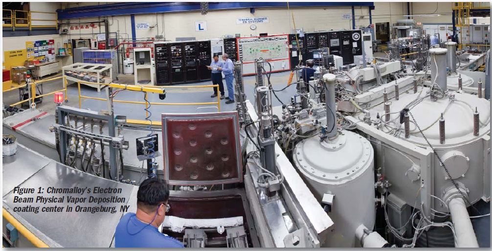

Chromalloy has been involved in coatings for oxidation, corrosion and thermal protection of gas turbine engines used in the aerospace and energy industries. This includes subjecting turbine section blades, vanes and ducts to diffusion aluminide or platinum aluminide coatings as well as overlay MCrAlY (M=Co or Ni, Cr=Chromium, Al= Aluminum and Y= Yttrium) coatings for oxidation and corrosion protection, and ceramic TBCs applied by air plasma spraying or electron beam physical vapor deposition (EBPVB) (Figure 1).
Figure 1: Chromalloy’s Electron Beam Physical Vapor Deposition coating center in Orangeburg, NY[/caption]
“In turbines, we use standard yttria-stabilized zirconia TBCs, and yttria-stabilized zirconia TBCs doped with neodmymium for low-thermal conductivity,” said Ravi Shankar, Chromalloy’s Director of Coating and Process Technologies. “Each of these coatings provides an insulating protective barrier to reduce part temperature, i.e., greater oxidation resistance which allows parts to operate longer.”

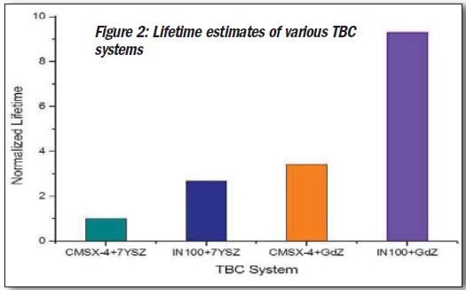

Meanwhile, researchers at the University of Rome-Tre studied two different superalloy substrates (IN100 and CMSX-4) used in conjunction with an NiCoCrAlY bond coat as well as ceramic top coat materials 7YSZ and GdZ. The study concluded that on both substrate alloys, GdZ possessed a nearly fourfold longer lifespan compared to 7YSZ (Figure 2).
Figure 2: Lifetime estimates of various TBC systems[/caption]
