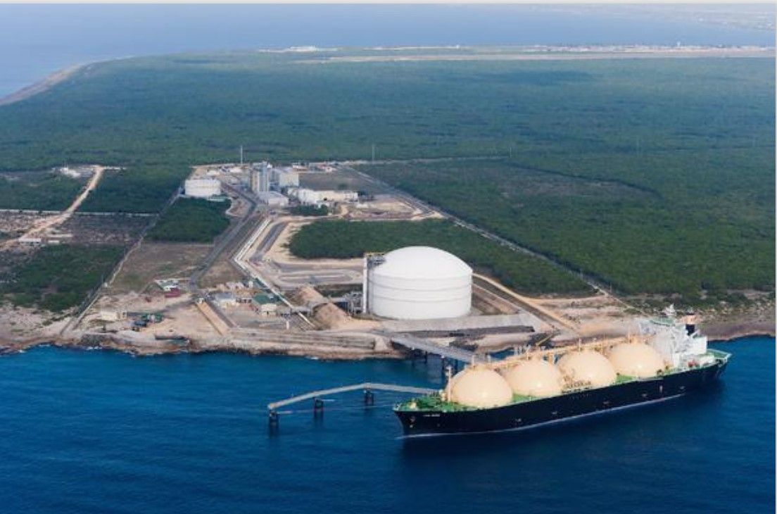

San Felipe power plant is expected to begin operation in 2027. It’s situated next to AES/ENADOM LNG terminal, with a total storage capacity of LNG of 250,000 m3.
