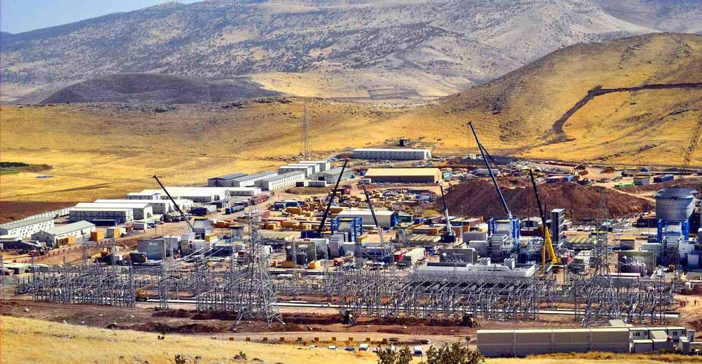

Bazyan Installation
Taurus Energy selected the AGP XPAND technology to modernize the Bazyan Power Plant and satisfy growing electricity demand throughout Kurdistan, including Mosul City and the Salahaldin Governorate. Bazyan features four 9E.03 gas turbines, on which the AGP XPAND systems will be installed, and two 9F.04 gas turbines powered by natural gas.
