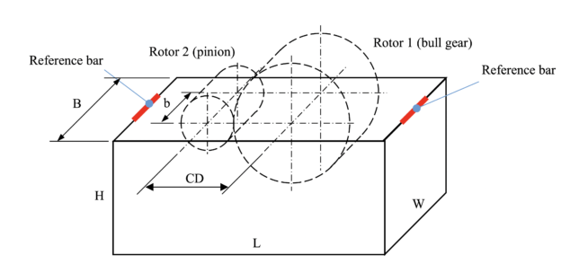

Figure 1. Schematic of a gear set in a casing lower port
b: gear face width in mm
B: gearing span in mm
CD: center distance in mm
H: Casing height in mm
L: distance between teh reference bars (length of the casing) in mm
W: Casing width in mm[/caption]
Under ideal circumstances, gear shafts are parallel with the load uniformly distributed in the gear mesh when running at rated condition (Figure 1). However, the casing can be distorted when the anchor bolts are tightened. As a consequence, the gear shafts may not be parallel.
Assuming one corner of the casing is lifted upwards due to bad contact between casing and baseplate, the casing would be twisted. Both rotors would be out of level, too. To determine tooth contact deviation, the difference between these angles must be calculated.
With this value known, the gear manufacturer can determine the influence on the load distribution and the allowable load for the gears. The gear manufacturer checks the tooth contact pattern in the factory while the casing was not distorted. Achieving the same alignment on site makes sure the tooth contact pattern is equivalent to manufactured condition.
