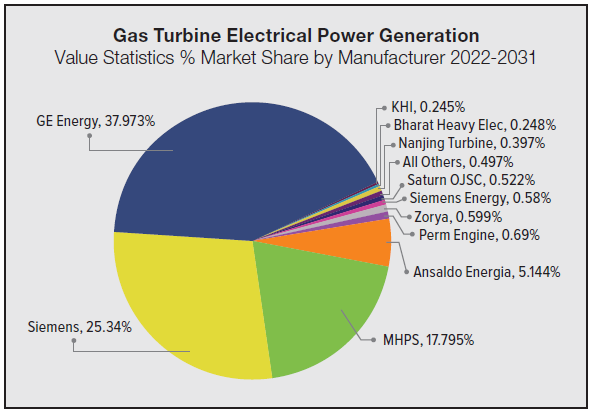

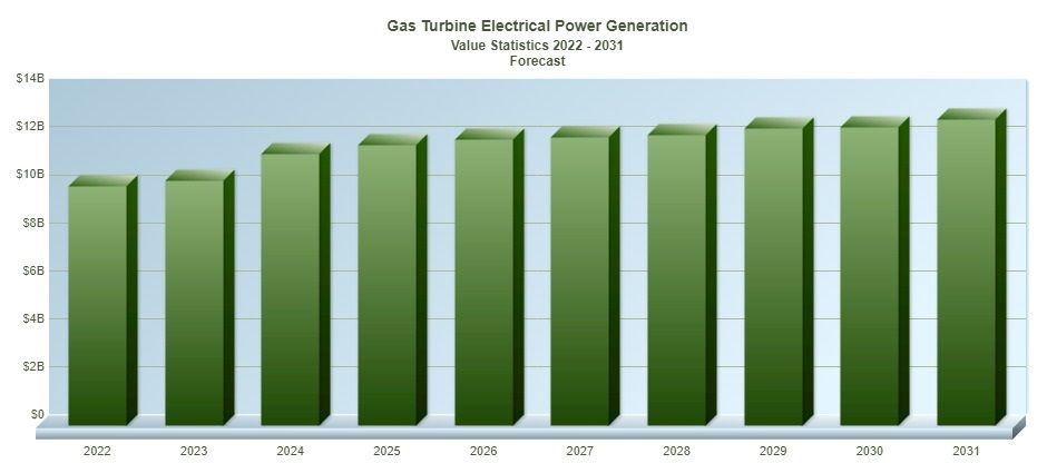

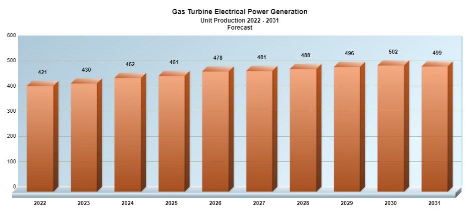

This Forecast International market analysis of gas turbine-powered electrical generation projects that sales over the period 2022-2031 will total $117.087 billion. This is indicative of a recovery in the gas turbine electrical power generation market. The recovery from the mid-2010s was somewhat thwarted in 2020 by the COVID-19 pandemic. As COVID-19 hampered all activity for a time, the pandemic should be seen as a blip in terms of turbine production and not a lasting effect.

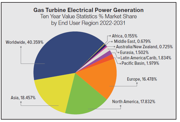

North America. The impact of improved distribution and control networks is continuing to blur the distinction between baseload capacity and the rest. Only nuclear-powered generation is unequivocally considered baseload due to its long run times at steady-state load. In contrast, fossil-fuel plants are experiencing a different pattern of operation that exhibits frequent starts, load-following, and shutdowns to meet seasonal demands. As quick-reacting gas turbines replace steam machines, this trend is likely to continue.

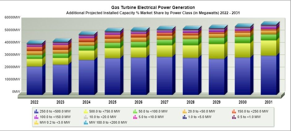

However, it is well understood that the majority of breakdowns happen when a plant is either started up or shut down. This evolving operational profile is likely to increase the frequency of outages and the cost of procuring replacement parts. In parallel, sales of G-,H-, and J-class machines are increasing as utilities place more importance on efficiency and vendors accumulate operational experience with new designs.
Western Europe. Germany, France, and other countries are moving away from nuclear and focusing on renewables. Existing natural gas capacity will likely not be augmented, but will probably not be shut down. There are currently plants sitting idle but some may be brought back online. However, Russia supplied a majority of Europe’s gas. With the ongoing war, supplies of natural gas cannot be taken for granted. Norway can pick up some of the slack and run at increased output until 2030. It remains to be seen how the natural gas situation develops in Europe.
Eastern Europe. Electricity generation is rising in Eastern Europe, including Romania, Poland, Slovenia, Bulgaria, and Czech Republic. Aging coal plants are being replaced with combined-cycle natural gas plants. Renewables are not as prevalent in comparison to Western Europe; however, combined cycle plants will likely lay groundwork for more renewables.
Southeast Asia. Southeast Asia’s energy demand is projected to grow by 80% by 2040 as the regional economy triples in size and population rises by almost a quarter to 760 million. As a result, it is likely that oil demand will rise from 4.7 million barrels per day in 2024 to 6.8 million b/d in 2040. At the same time, natural gas use will grow by almost two-thirds to around 265 billion cubic meters. In sharp contrast to other regions, coal demand will greatly expand and overtake oil to become the largest fuel. Renewables will make inroads but should decline from 26% of the fuel mix to 21%. The share of fossil fuels will rise to 78% by 2040.
India and China. India and China are the two most populous countries in the world by a wide margin. Both are short on electrical power. The generation capacity is inefficient and a major cause of pollution, while grids are incomplete and lack proper coordination and administration. As in Eastern Europe, coal plants will be replaced by natural gas.
