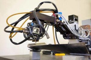

Figure 4: Measuring residual stress on a turbine blade via the x-ray diffraction technique[/caption]
Quality assurance and inspectionOnce the optimal engineered residual stress fields have been established and formally defined for components of interest, they can be monitored and audited over time to confirm that components have been correctly processed by a given supplier. It should be stressed that the selected methodology of measurement must be accurate, quantitative, and suitable for the measurement of surface, near-surface, and subsurface residual stresses so as to account for both crack initiation and propagation considerations in life modeling and analysis. An example of XRD being applied to the measurement of engineered residual stress in a turbine blade can be seen in Figure 4.
