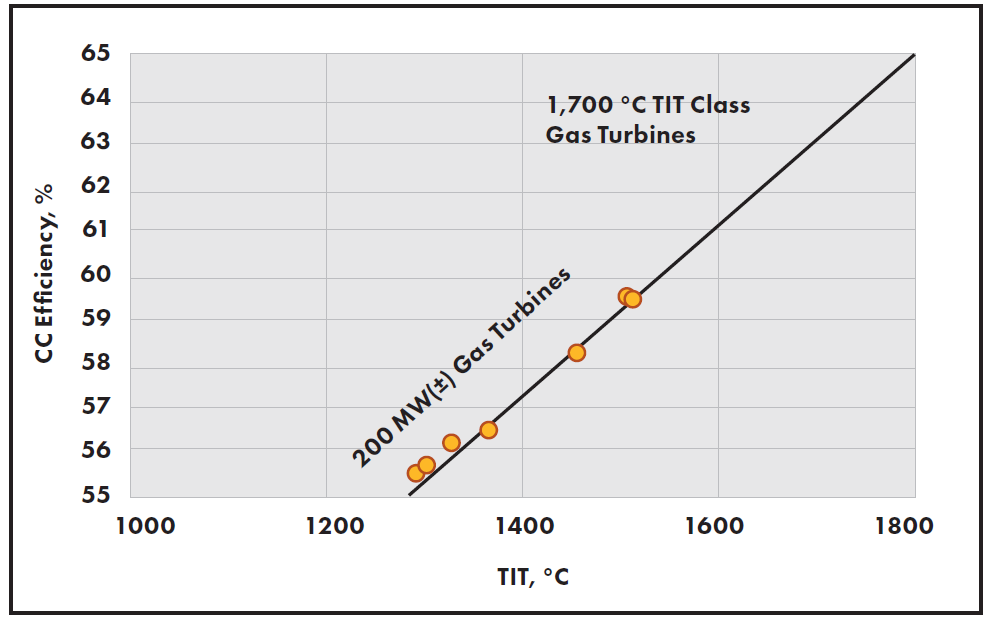

Gülen laid out what it would take to make the concept work at a more reasonable level of hydrogen consumption. He suggested that research and development was needed into an efficient turbine in the 200 MW range as the best chance of making hydrogen combustion a success (As shown in the figure, there is a big gap between those mid-size units and large heavy duty gas turbines). The proposed machine is detailed in a paper he gave along with Justin Zachary of Expertech Engineering at the proceedings of ASME Turbo Expo 2022 (GT2022-81807) entitled, “Feasibility of achieving 62% combined cycle efficiency with a 200 MW gas turbine”.

According to Gülen, a better approach if hydrogen-based gas turbine combustion is to ever gain traction would be to focus on a smaller model. A 200 MW gas turbine might burn only about 16 t/h of hydrogen or about 900 MW of green power. However, this requires investment. Such a machine would need to incorporate some of the features developed for J-class gas turbines that led to the achievement of combined cycle efficiencies exceeding 62% such as larger air flow and increasing the firing temperature.

“Getting to 62% efficiency would make a big difference to the viability of a 200 MW turbine that could deliver meaningful hydrogen-fueled generation,” said Gülen.
Most 200 MW-range turbines are E-class, though a few are F-class. An upgraded F-class would be required for hydrogen generation to bring combined cycle efficiently beyond the 60% mark. A couple of existing models have some of the right characteristics, for example, the 100 MW model from Mitsubishi Power (H100).
Gülen’s ideal configuration for combined cycle hydrogen generation would be two-shaft with the compressor and three-stage high pressure (HP) turbine forming a self-balanced shaft. The low pressure (LP) turbine would have two stages. Using reasonable design assumptions, the combined cycle performance would be about 303.1 MW and 61.34% net LHV.
From a thermal cycle perspective, such a product is conceivable with a high-cycle pressure ratio and a J-class turbine inlet temperature. A two-shaft configuration is needed to achieve a mechanically feasible design. But high investment would beneeded in areas such as compressor and combustor design. OEMs are unlikely to make such an investment unless they can clearly see demand from the market. In Gülen’s opinion, such a product may only be viable in high fuel cost markets.
