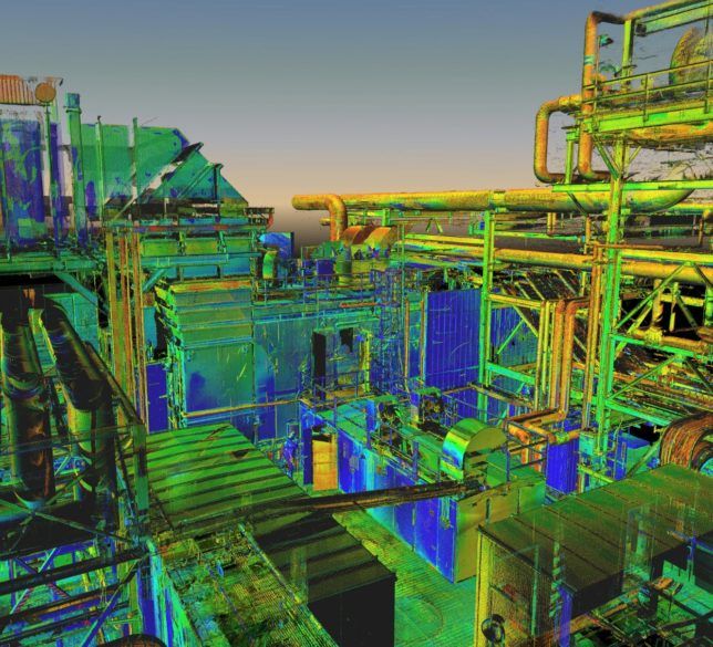

Laser scanning is a way to minimize rework due to as-built errors. It is accomplished via a series of 360° × 290° 3D scans that are aligned precisely to generate an accurate and complete digital copy of the real world. This digital copy, accurate to ±1/8", displays each element’s size, location and orientation.
A scanner sends out a light wave and collects what is reflected back as a mass of points. The intricate nature and layout of each GT, the fuel nozzles, combustion cans and manifolds configuration dictate how and where the scanner is placed. Incorrect placement results in partial coverage, shadows (where one object obscures another), and holes. Best practices on how and where to place the scanner and reference targets have been developed over time.
The scanners used in power stations, oil & gas plants, and petrochemical facilities are eye-safe and conform to the same safety protocol standards as a cellphone or regular digital camera. They do not generate heat, trip sensors, or interfere with electrical equipment. Their range is over 185 meters.
Two surveyors can generally capture all the essential details of the enclosure, gas fuel module, water treatment skid, accessory compartment, air inlet, exhaust and all related structural, piping, and other equipment within a 10,000 ft2 area in less than two days.
This first stage deliverable is a collection of 2D views known as a Visual Database. The database is like a digital site-walk and allows the design team to investigate the project area, take measurements and check dimensions on their computers.
This data is then used to generate a replica 3D as-built model, commonly known as a digital twin. It can be delivered in any mainstream 3D CAD format, including AutoCAD, Microstation. Creo 3.0, AVEVA E3D, Catia, and NX. It takes roughly 10-to-14 days to generate.

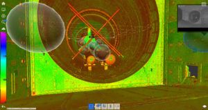

Caption: Laser scan of the inside of an inlet duct
