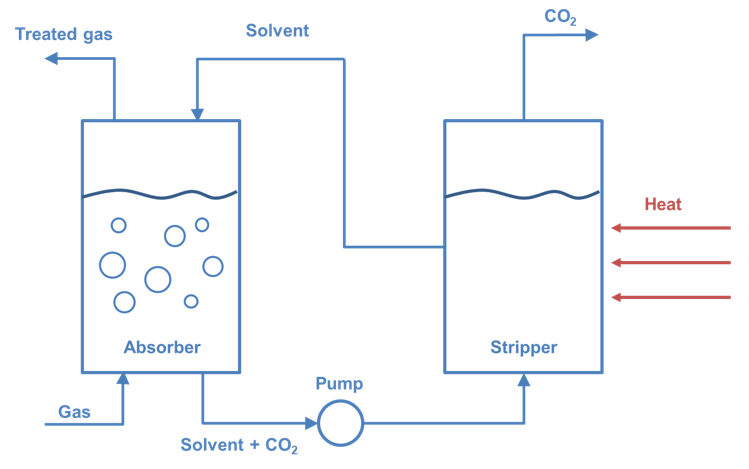

Most attention, to date, has been lavished upon solvent-based capture i.e., the gas stream is exposed to a liquid medium to absorb CO2 via some kind of physical or chemical mechanism. Regeneration is also needed to break absorbent-CO2 bonds.

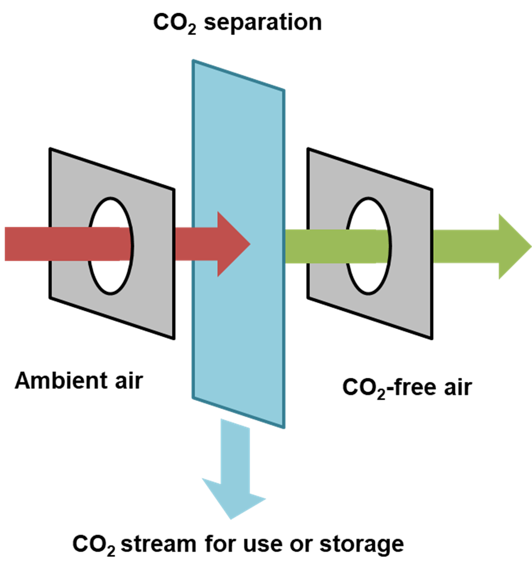

Drawbacks include high energy consumption, corrosion, difficulties in scaling, and raw economics. Why spend money to develop and implement the technology in an environment that shows little love for fossil-based fuels? Nevertheless, advances have been made. Amine-based solvents from Mitsubishi have been used in the Petra Nova facility in Texas. Shell Global’s CanSolv is another solvent being used at the Boundary Dam project in Canada. Similarly, physical absorption solvent breakthroughs have been made such as Lurgi’s Rectisol process using chilled methanol as a solvent. Further areas of development include: solid sorbents developed by Svante in conjunction with Chevron and others; the Polaris membrane by Membrane Technology and Research in collaboration with the U.S. Department of Energy; SES Innovation’s cryogenic carbon capture; and FuellCell Energy’s fuel cell technology for carbon capture, using electrochemical membranes to separate CO2 from industrial waste gas streams. Further, Chart Industries (owner of LA Turbine) has developed Cryogenic Carbon Capture (CCC) technology. The cost to produce cement and capture CO2 using CCC technology is said to be 24% higher than producing cement with no capture.
