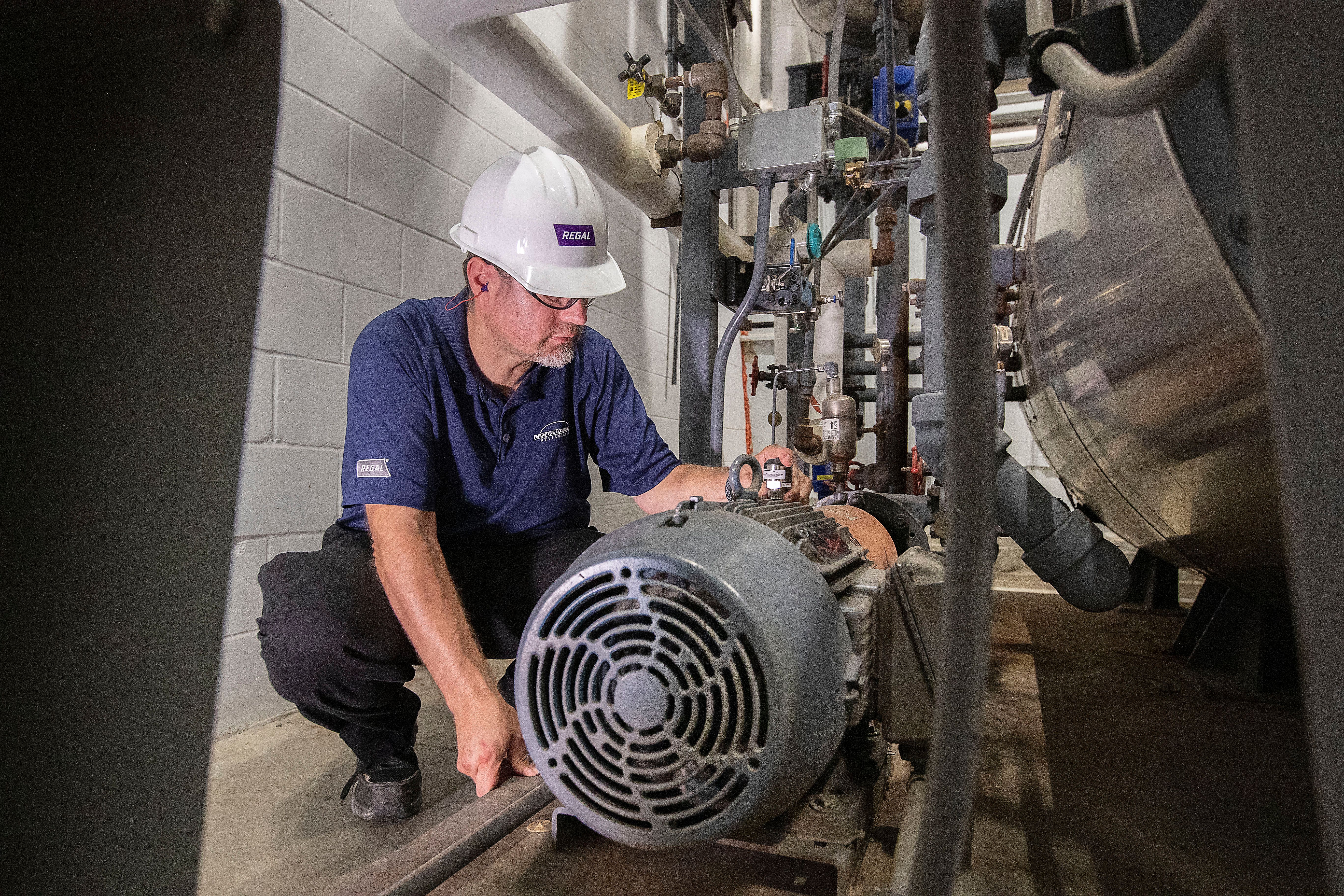

Regal continues to expand Perceptiv on-site and remote monitoring and diagnostics to help our customers install and monitor equipment 24/7 or as needed. These tools save money by diagnosing potential problems before they happen. Examples include torque monitoring, vibration observation, and motor current signal analysis.
The Regal Tag-It Program powered by Perceptiv intelligence is an asset management platform to view details on mechanical and electrical assets in operation and reduce redundant or obsolete inventory. The program creates a path for continuous facility improvement by enabling faster maintenance and simplifying the MRO procurement process. In addition, users can easily add Perceptiv wireless monitoring to keep an eye on critical equipment. This 24/7 monitoring technology will help customers to increase equipment reliability and maximize production. The combination of hardware, software and “humanware” provides a new way for users to interact with Regal products and their equipment. All of this helps customers to harness the power of IoT in their facilities.
