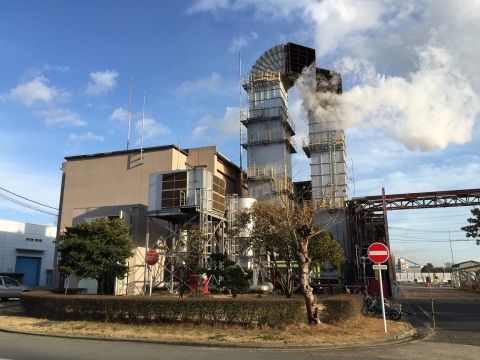

Actual-pressure combustion testing facilities that carried out the hydrogen-mixed firing test (Photo: Business Wire)[/caption]
