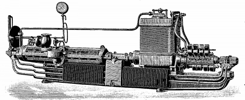

Parsons thought correctly after he had invented the reaction steam turbine that the expansion process could be reversed and a multi-stage axial flow air compressor would be possible by reforming the rotating blades to become fans and then stage by stage air could be compressed. He invented the axial flow compressor in 1901 and called it “The Turbo-Blowing Engine”. At a normal speed of 3000 RPM the compressor-blower put out 10 psig and delivered 21,000 cfm of free air. He built a number of these highly successful blowing machines for steel mills.
At 3600 RPM the machine would put out 19 psig. These machines were oil-free and far superior to the old reciprocating compressors because they gave a continuous and steady flow compared to the pulsating flow of the reciprocating ones. The cross-sectional drawing shows that there were about 15 stages of rotating and stationary blading. These machines were truly axial flow compressors.
