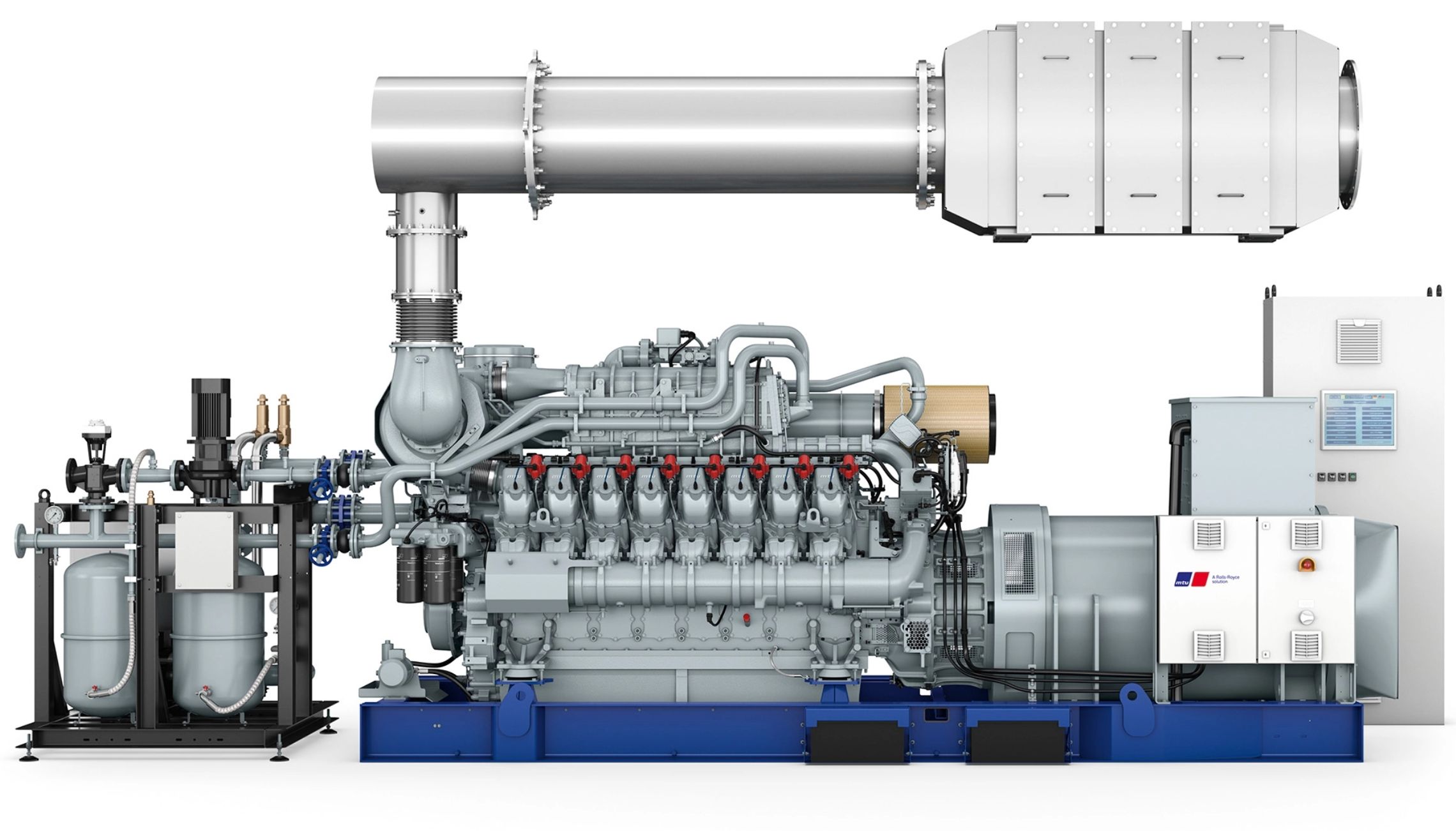

  • The updated mtu Series 20V4000 L64 engine offers a 45-second fast-start capability, delivering 2.8 MW for data centers and grid stabilization.
  • Eliminating the gearbox in the new genset model allows for significant space savings in data centers.
SHOW MORE
By using a fast-starting independent gas power plant, data center operators may come online faster with increased energy security and electricity to the grid.
Beginning in 2026, Rolls-Royce will launch an updated mtu Series 20V4000 L64 engine for the 60-Hz market. With a new fast-start capability, the genset will deliver 2.8 MW in 45 seconds to power data centers and stabilize the grid. Compared to the previous model, performance has been increased by 10% and the genset does not require a gearbox, allowing data center operators to achieve notable space savings. Rolls-Royce’s fast-start engines can supply emergency power in data centers, but also continuous power in combination with diesel models.
