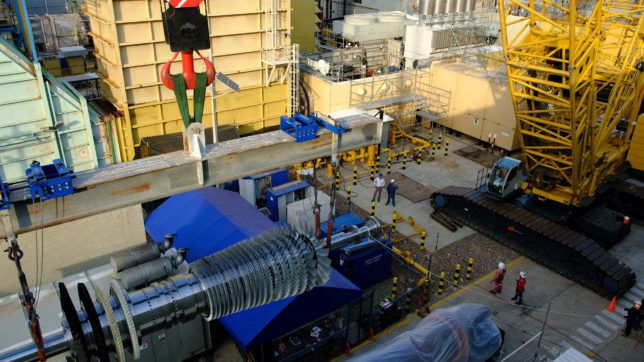

One of the SGT6-3000E units received a new bolted compressor rotor. This addresses issues experienced after extended operation with the original shrink–fit compressor disk. The new rotor has stacked, bolted compressor discs. It uses design elements from the F-turbine rotor, which allows engine ramp rates of up to 24 MW per minute. It also has visible locking key hardware to facilitate rapid disassembly. This bolted compressor rotor has a 150,000-hour lifespan. Celsia’s existing Siemens SGT6-5000FC+ GT already possessed a bolted rotor. The other SGT6-3000E unit was fitted with a refurbished rotor in 2009 during its second major inspection.
