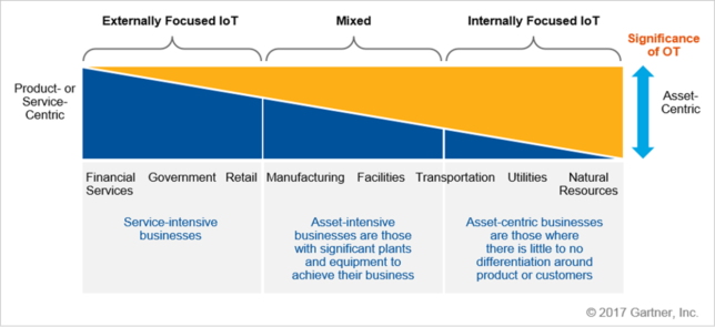

Being asset-centric, the good news is that power producers and utilities are less at risk than other industries, such as financial services. But initiatives, such as smart metering, remote monitoring, IoT, and the cloud are changing that.
“You can’t eliminate risk, you can only manage it,” said Affelt. “Being compliant does not equal being secure. It requires tight collaboration between IT and operational technology (OT) staff.”
