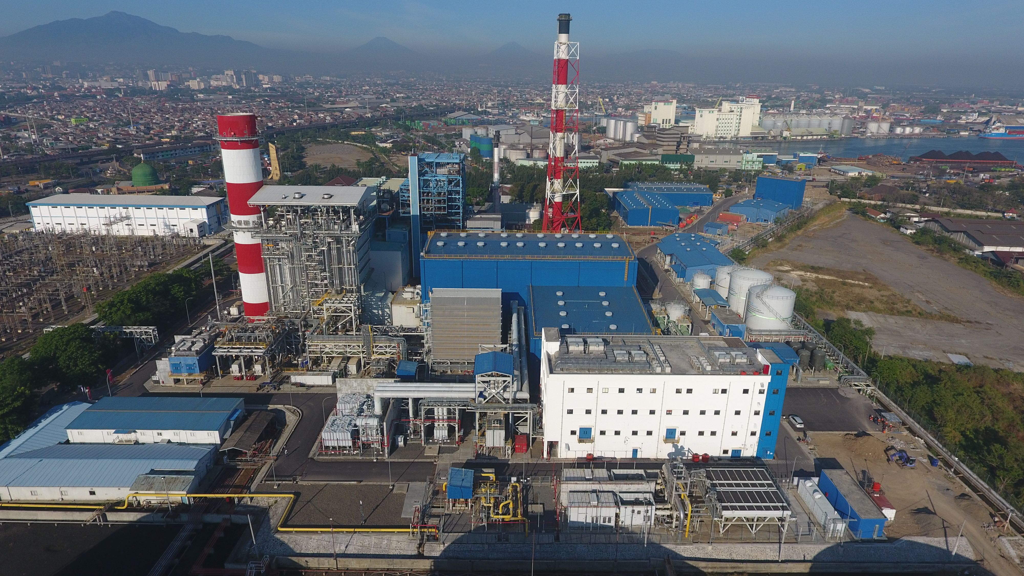

PLN Indonesia Power’s (PLNIP) 780-MW Tambak Lorok combined-cycle power plant began commercial operation in Tanjung Mas, Central Java. Tambak Lorok Block 3 is equipped with GE Vernova’s HA combined-cycle equipment and will deliver the electricity required to power approximately 5 million homes in Indonesia.
“Tambak Lorok represents a milestone for Indonesia, adding to the system a large-capacity plant that brings stability to the country's electricity matrix,” said Edwin Nugraha Putra, CEO of PLN Indonesia Power. “Tambak Lorok is in line with the national energy policy to lower emissions from the power sector. As more coal-fired plants are retired, the need to add more reliable and flexible power that provides greater grid stability is essential. We trust GE Vernova, Marubeni Corp. and Hutama Karya, as the EPC, have delivered quality and safety in building this power plant to provide reliable and more sustainable electricity to the Java grid.”
Specifically, the plant uses GE Vernova’s 9HA.02 gas turbine, a STF-D650 steam turbine, the Once Through heat recovery steam generator, and balance-of-plant equipment. GE Vernova also signed a 15-year service agreement to manage project lifecycle, training, and maintenance, enhancing operational performance and plant reliability. Training will support knowledge transfer and the skills development of PLNIP’s operations team.
