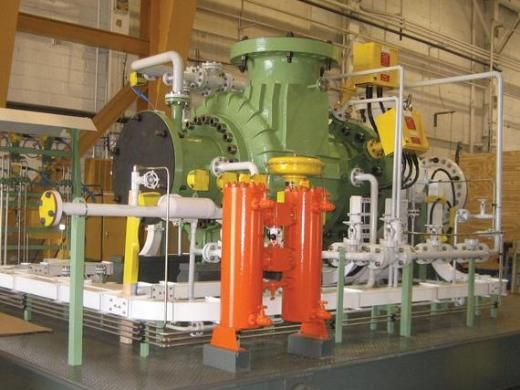

CASE STUDY
An NGL plant that has two turboexpanders operat-ing in parallel, faced a reduction in production. Management decided to switch to a different oper-ating mode that used one turboexpander-compressor train operating along a JT-valve. The turboexpander tripped due to high radial vibration (unbalance). The other turboexpander was started and ran alongside the JT-valve. After running for approximately 12 hours, the second turboexpander train also tripped on high radial vibration. Neither turboexpander could run at normal operating speed, as they tripped on high unbalance vibration if the speed slightly exceeded the minimum.
Their operation was shifted back to two turbo-expander trains operating in parallel, but at minimum speed to avoid tripping. When time allowed to inspect the machines, it was found that both compressors had broken a piece of the leading edge of one of the vanes. After investigation it was concluded that both turboexpander compressors ran in the stonewall region, which caused over-loading that excited impeller natural frequency and high vibration. Subsequently, this led to fatigue failure at the leading edge of the compressor vanes causing the severe unbalance and tripping of the train. The conclusion was to modify the control system setup to keep the turboexpander-compressor away from the stonewall region.
Although some control system suppliers utilize a suction anti-choke valve at the compressor suction side, this control scheme did not work effectively. When the suction anti-choke valve tried to prevent the compressor flow from pushing it to stonewall, the suction anti-choke valve was counteracted by the demethanizer controller trying to maintain constant pressure. As a result, the compressor anti-choke valve was bypassed, and hence did not protect the compressor from operating in the stonewall region.
A proposed control modification requires a dis-charge anti-choke valve as it will provide the proper control by increasing the speed of the turboex-pander and decreasing the J-T-valve flow. Preventing the turboexpander compressor from going into the stonewall region is achieved by creat-ing back pressure on the compressor discharge that is already preset at a certain flow in the compressor control system. The rest of the flow coming out of the demethanizer overhead will be directed to the inlet of the sales gas compressors through a bypass line upstream of the suction side of the compressors. This yields to a slight increase in the demethanizer pressure, which is within its design. Moreover, the turboexpander speed is increased to its maxi-mum possible setting, to allow for the brake com-pressor to stay within its designed operating range and keep it away from the stonewall region.
