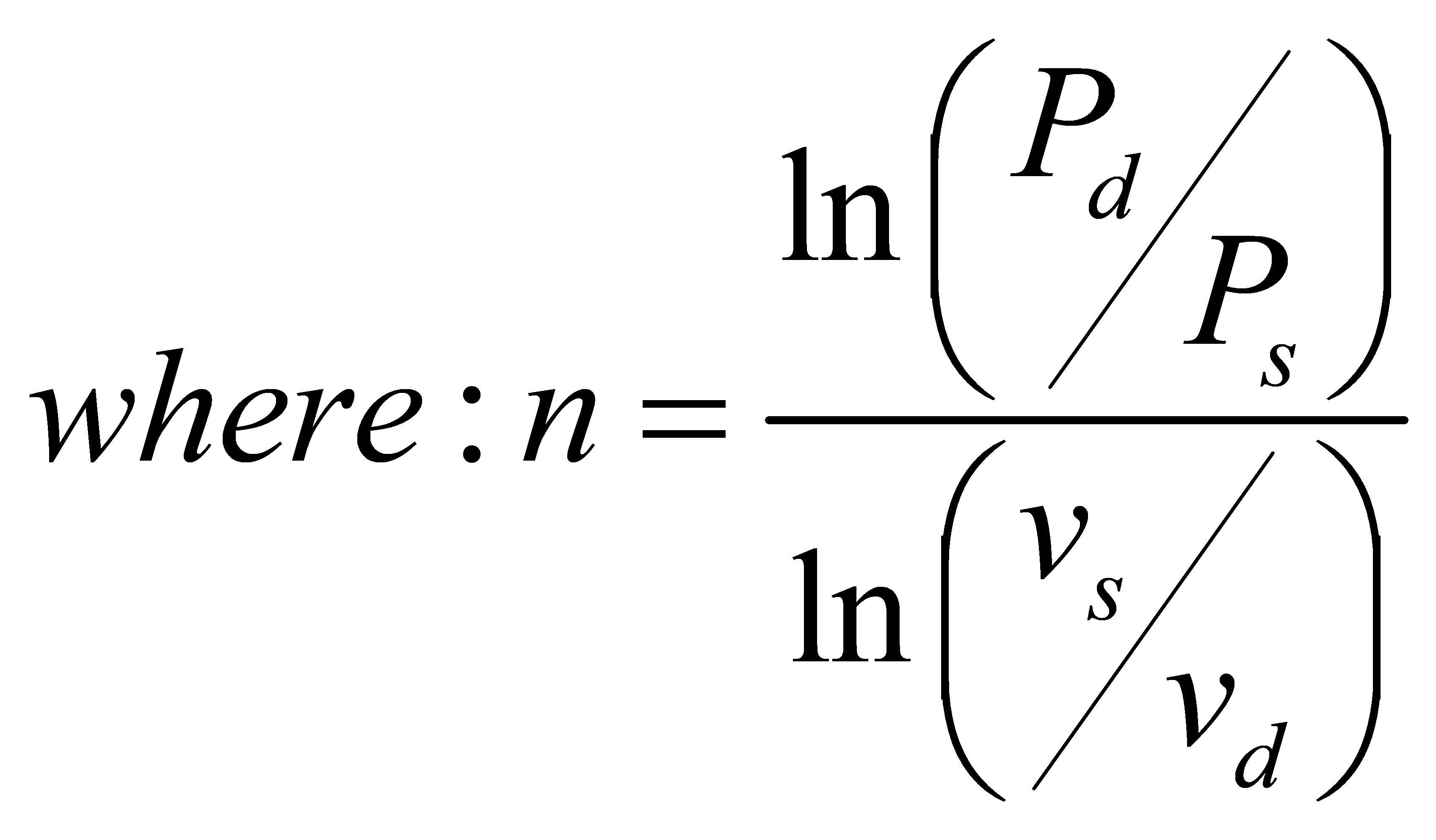

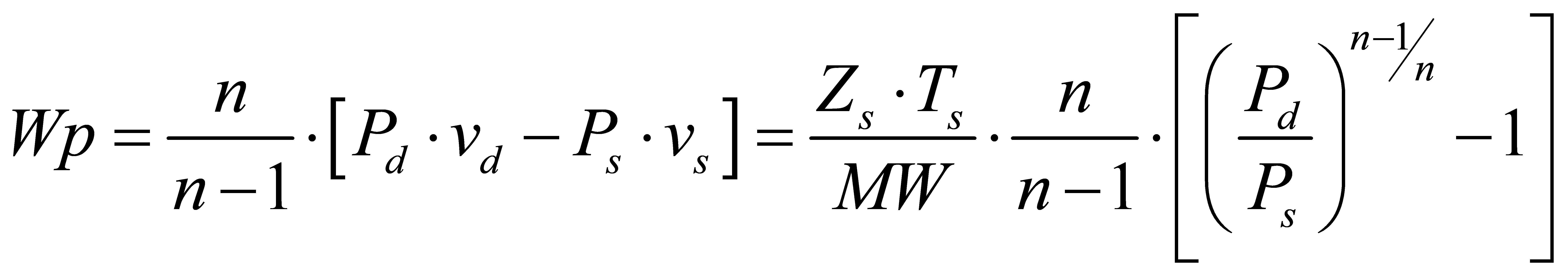

Industry standards, ASME PTC 10 and the ISO equivalent, ISO 5389, define some fundamental compressor performance measures that are universally accepted to describe their thermodynamic behavior. The polytropic work (or poly-tropic head) represents the useful work that is applied to the gas to raise its pressure from suction to discharge conditions. It is expressed by the following equation based upon the work of Schultz and the definition of a polytropic process for an ideal gas:
This equation shows that the polytropic work (Wp) is only dependent upon the compressor suction and discharge values of pressure (P), temperature (T), specific volume (v), and the gas molecular weight (MW). The average polytropic exponent, n, included in these relations is also derived from these parameters. These properties are all available from some equations of state for the gas. However, the polytropic work (useful work) does not represent the total amount of work required by the compression process.

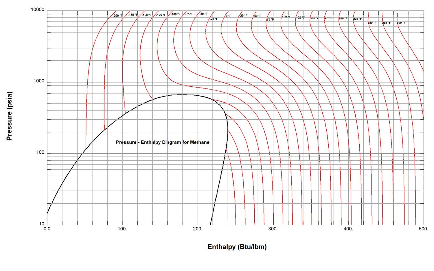

A more visual comparison of the enthalpy behavior of a gas is available through the examination of a pressure versus enthalpy diagram for a substance. Figure 2 is such a diagram for pure methane. The red isotherms which display near vertical linear characteristics at low pressures and higher temperature values reflect ideal gas behavior. These isotherms demonstrate increasing curvature at higher pressures which indicates progressive real gas performance with influences of both temperature and pressure present. A perfect gas would display consistent deviations in enthalpy for equal deviations in temperature and this is approximately noted at the lowest pressure levels and moderate temperatures where the changes in specific heat with temperature are minimal.
Although perfect and ideal gas relations may be limited in their application to given pressure and temperature conditions, it is assumed that real gas relations are valid across a broad range of con-ditions including ideal gas conditions. The corresponding values of specific volume (compressibility factor), enthalpy and entropy are more generally applicable when compared to the sim-pler perfect and ideal gas thermodynamic models.

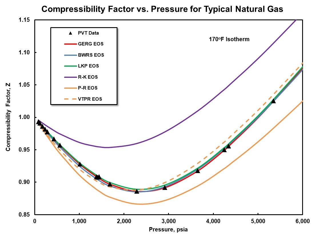

One example of an accuracy evaluation is provided in Figure 3 for a typical natural gas mixture. It is approximately 90% methane, 3% ethane, 1.5% propane, 1.7% carbon dioxide, and 1.7% nitrogen by volume. The experimental data was collected along a 170oF (76.7C) isotherm and a pressure range from atmospheric to 6000 psia (413.7 Bara). The experimental data points are provided as black triangles. Curves for the six different equations of state evaluated are included and designated in the legend.
The cubic equations of state display the largest deviations from the measured data. It should be noted that the volume-translated Peng-Robinson, VTPR EOS, shows improved agreement. The remaining equations of state demonstrate very good agreement with the experimental data. One final observation that should be highlighted is the good agreement with all equations of state. The exception is the R-K EOS at pressures below approximately 500 psia (34.5 Bara) along this isotherm. This is due to the behavior of this mixture at the lower pressures approaching those of an ideal gas at this relatively moderate temperature.

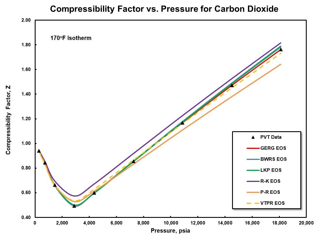

A second example is presented in Figure 4 for pure carbon dioxide across an increased pressure range up to a maximum of over 18,000 psia (1241 Bara). Good agreement is once again demonstrated for most of the equations of state evaluated with the largest deviations evident for the simpler, cubic equations of state.
These two figures are fairly representative for a large number of gas mixtures. But it is prudent to have a discussion between the equipment manufacturer and end user concerning the most appropriate equation of state to utilize for a specific application. As noted previously, if there is not ade-quate shared experience for unique gas mixtures, it may require the development of a program to empirically determine PvT data for the mixture and evaluation against a number of different equations of state to determine the most accurate.

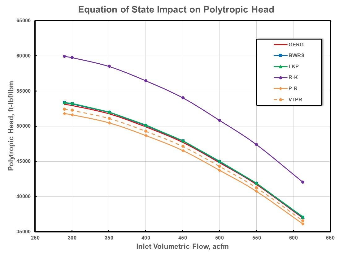

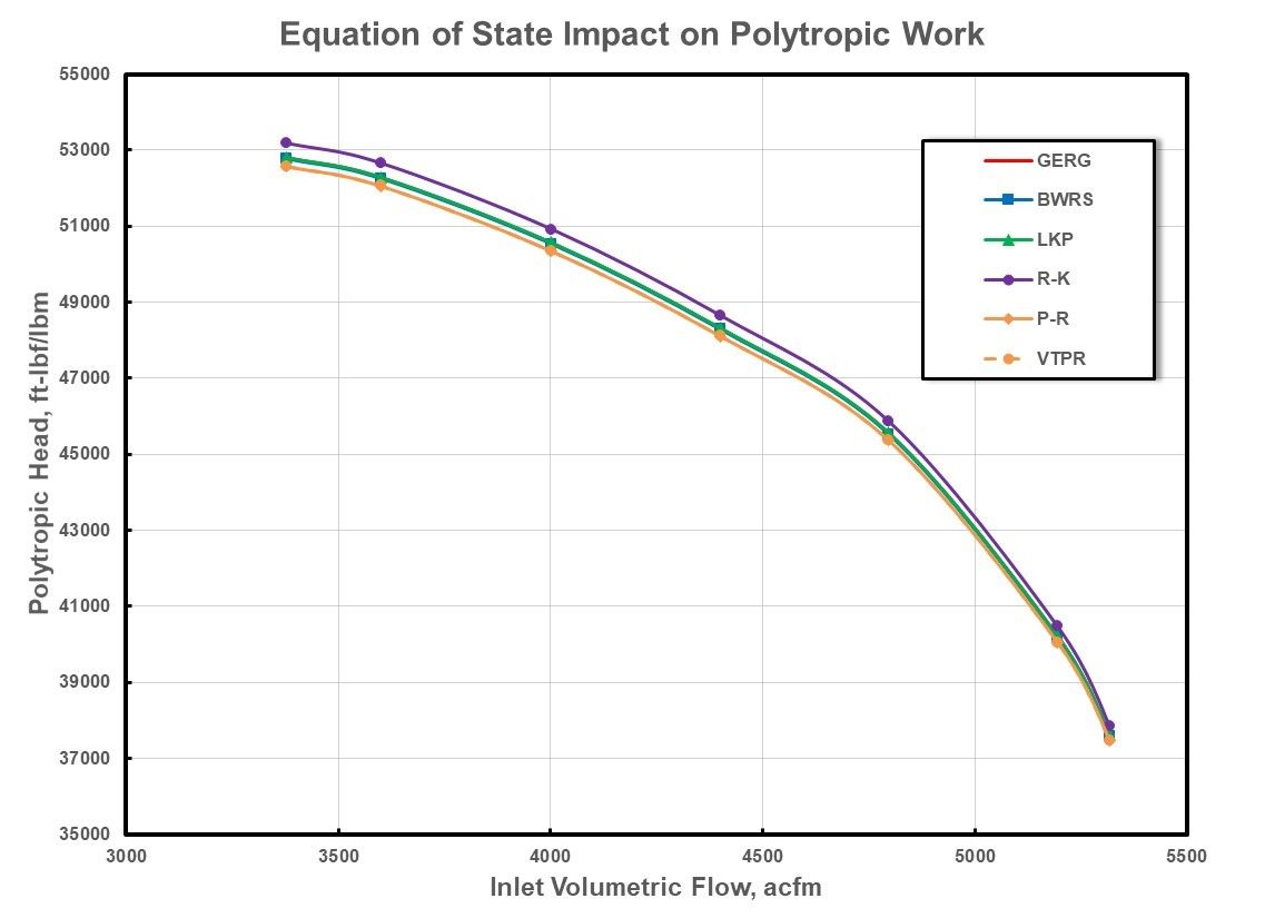

Baseline data included in the following comparisons was determined using the GERG EOS due to its demonstrated minimal deviation from published PvT data. Two examples are presented with both based upon the typical natural gas com-position defined previously. The first example addresses the comparative performance of a low-pressure case with a common suction pressure of 100 psia (6.89 Bara) and temperature of 100oF (37.8C). Discharge pres-sures range from approximately 208 psia (14.34 Bara) at higher inlet volumetric flows to 273 psia (18.82 Bara) at low flows near surge. Seven spe-cific operating points were evaluated and are presented in Figures 5 and 6. Polytropic work is plotted in Figure 5 versus an arbitrary range of inlet volumetric flow rates. Good agreement is displayed between the various equations of state.

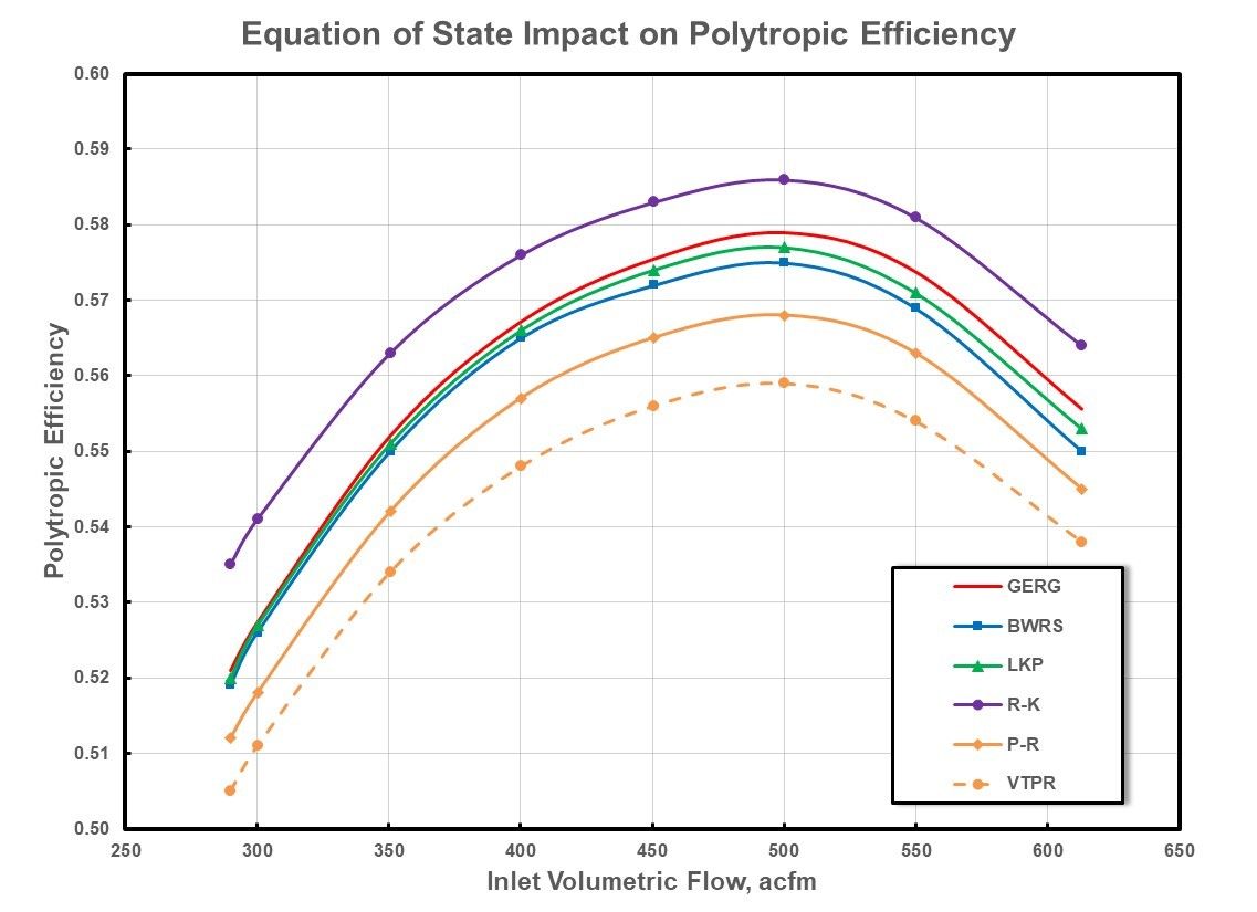

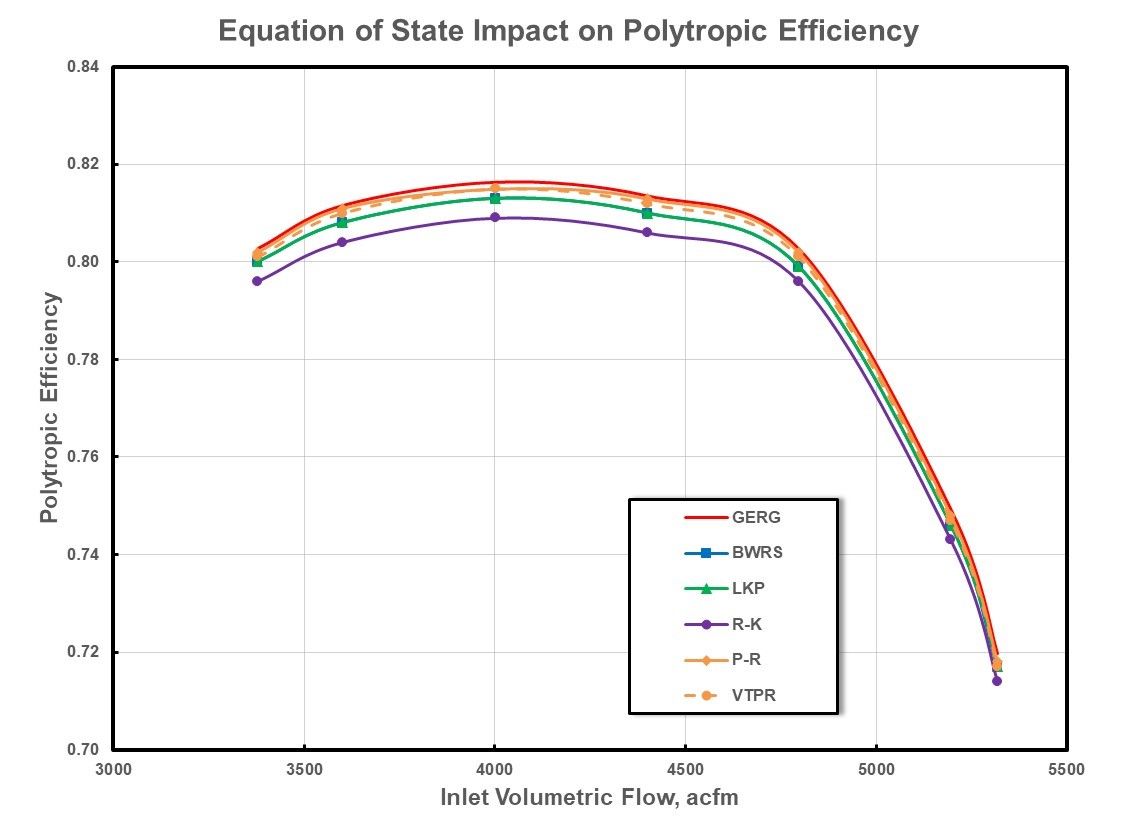

Although there appears to be more deviation in the polytropic efficiency than the polytropic work, a closer look at the scaling in Figure 6 also confirms good agreement between the different equations of state. These results could lead one to believe that there are insignificant differences based upon the choice of an equation of state. However, it should be recognized that there was little deviation in predicted compressibility factor in this range of pressures in Figure 3. Gas properties within this range of pressures and temperatures are near ideal with compressibility factor values near unity and with minimal differences between suction and discharge conditions between the equations of state.
As the pressure range of the compression application increases, differences in predicted compressibility factors become more evident. Using a similar procedure to predict discharge pressure and temperatures from defined suction conditions and a selected baseline polytropic work and efficiency curves, a comparison of calculated polytropic work and efficiency character-istics can be developed for the chosen set of equations of state.
Figure 7 provides these curves using a common suction conditions of 2000 psia (137.9 Bara) and 100oF (37.8C) with discharge pressures ranging from 4349 psia (299.8 Bara) to 5553 psia (382.9 Bara) as determined with the GERG EOS.
Good agreement is evident among the more complex, virial type equations of state in comparison to obvious deviations with the cubic based equations of state. Significant deviations are noted for the R-K EOS across the entire inlet volumetric flow range, whereas the amount of deviation is decreased for the P-R EOS and minimized further for the VTPR EOS. This behavior lends credibility to the proposition that equation of state compressibility factor accuracy also translates to reduced uncertainty in the prediction of compressor performance.
An equivalent evaluation of the polytropic efficiency is presented in Figure 8 for the higher-pressure case. Once again, greater deviation from the baseline is evident for the cubic equations of state. However, it is noted that the VTPR EOS displays greater deviation than the P-R EOS. This apparent shift in efficiency is due to the differences in the prediction of the enthalpy of the gas mixture at suction and discharge conditions, specifically the departure enthalpy term which is also a function of the compressibility factor. Recall that the efficiency is the ratio of the polytropic work to the enthalpy rise from suction to discharge conditions.
These examples demonstrate that the choice of equation of state used to estimate the thermodynamic properties can impact the calculation of recognized compressor performance parameters, particularly as gas conditions progressively depart from ideal gas behavior. A robust equation of state should adequately predict both ideal and real gas conditions. While these examples address a representative gas composition and set of operating conditions, the results may not apply to all potential applications. An evaluation of the most accurate equation of state for a specific application should be com-pleted to ensure the most accurate estimates of compressor performance parameters are obtained. It should be noted that the gas power required for the different equations of state at a common inlet volumetric flow rate shows less deviation across the wide range of conditions. This is due to a cancelation of compressibility factors between the polytropic head and flow rate relations, but does relate to a difference in mass flow rate for a common value of volumetric flow rate.
