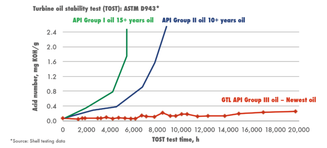

Developments in base oil technology have been achieved with the gas-to-liquid (GTL) process. Production of Shell GTL base oils begins with gasification, where the methane from natural gas reacts with pure oxygen to produce synthesis gas. The synthesis gas is fed through a reactor and converted to a liquid called syncrude. The liquid is fed into a hydrocracker to break down molecules and form new ones and the new molecules are distilled into GTL base oils for use in finished lubricants.
The result? The GTL process transforms natural gas into liquid and solid hydrocarbons with high purity. Pure hydrocarbon base oils are created with a narrow molecular distribution, a high viscosity index and a low level of contaminants (such as nitrogen and sulfur). These GTL base oils respond well to performance additives, enabling the production of turbine oils with good performance even under severe operating conditions.
Compared with conventional mineral oil-based turbine oils, this new class of lubricants slows down the rate of oxidative and thermal degradation. In addition, these oils release air faster, resist foaming and separate water more rapidly. They also minimize the formation of oil-insoluble degradation products, such as varnish that can deposit on valves and filters and prevent the turbine from starting.
