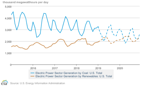

According to data published this month in the Energy Information Administration (EIA) Short-Term Energy Outlook, renewables may even trump coal through the month of May as well.
As the chart below indicates, the EIA sees renewable generation topping coal-fired output sporadically this year, and again in 2020. The estimates in the EIA outlook show renewable energy generating 2,322 and 2,271 thousand megawatt-hours (MWh/day) per day in April and May, respectively. This would top coal’s expected output of 1,997 and 2,239 thousand MWh/day during the same two months.
To be fair, there are seasonal considerations. Of particular note, is the long-held practice of taking coal plants offline during the lower demand periods of the spring (and fall) to perform maintenance and upgrades to ensure that they are ready for the higher demand of the summer and winter seasons. In addition, spring tends to be peak time for hydro generation.

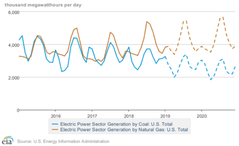

It is worth noting that the first instance of natural gas-fired generation exceeding coal’s output happened not so long ago—April 2015 (also likely to do with seasonal variations in demand). Subsequently, the two major fossil fuels—coal and gas—went back and forth on market share through early 2018, with coal generating more in the winters and natural gas winning the summer generation battle (see chart below). The final monthly crossover point occurred in January 2018, and natural gas has held the uncontested top spot in electricity generation ever since. On an annual basis, the two fuels each accounted for about 33% of the electricity market in 2015; since then, their trajectories have taken different paths. By 2018, natural gas’s share had climbed to 35% while coal’s had dropped to 27%. The trends for both are expected to continue.
