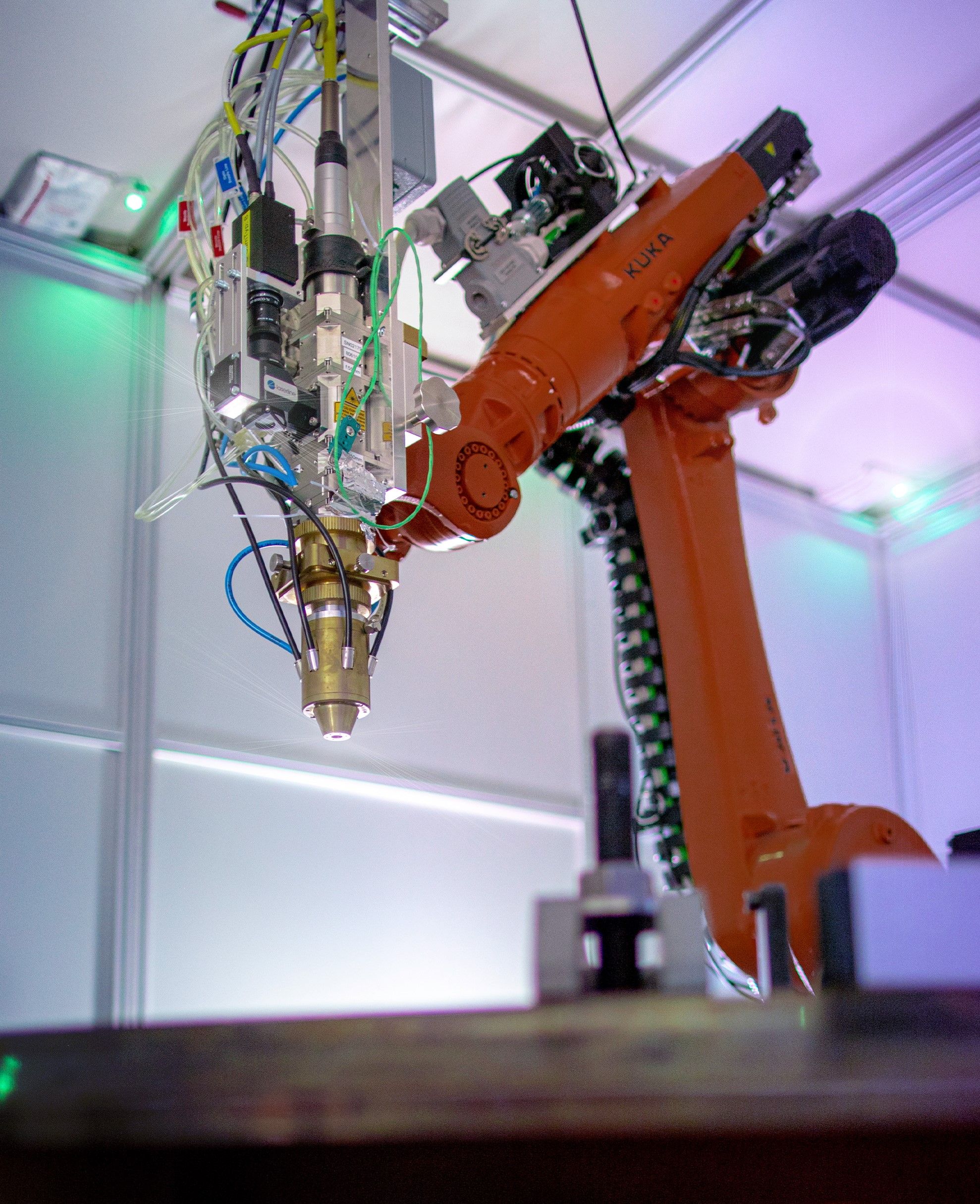

Alongside traditional welding technology, Siemens uses mobile robotics systems for additive refurbishment options, which allows both small and large components to be repaired on site, hence the phrase "3D printing out of the box." This system comprises a Kuka robot, a 4-kW powder laser, a turntable, and a control system. This cell is transported to the site, assembled along with mobile laser walls and, if required a roof, calibrated and is ready to start work within hours.
Improving the speed of deposition
The laser can apply approximately 2.5 to 3 kilograms of metal powder in an hour, more than ten times the speed of the manual TIG welding process where the deposition rate is around 200 grams. The laser has the accuracy to cope with nearly all geometries.
