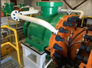

Picture shows coated fasteners and marine paint systems. Also shown are temporarily applied coatings on machined
surfaces[/caption]

A mock-up may be considered where high dollar value machinery cartridges can be shipped and stored separate from the equipment package/skid. Compander plug-in units, or mechanical center sections (MCS), are a type of rotating machinery that can benefit from the use of a mockup during shipment and skid installation. This approach permits the critical machinery to be stored in a clean, preserved state for as long as possible before the required installation date, which minimizes the risk of degradation. This picture captures several preservation methods employed on offshore applications. Coated fasteners and marine paint systems are displayed. Also shown are temporarily applied coatings on machined surfaces.
Finally, the large orange flanged center section is a compander MCS mock-up, which also replicates instrument connection points and is designed to allow low pressure blowdowns of piping prior to installation of the MCS. The mockup allows all fit up of piping and instrumentation to be conducted in the factory and field without the need to install the actual equipment. These pictures show the completed MCS mounted into the base of a purged shipping container (far left) and the fully assembled container, complete with inspection window (to permit visual inspection of the machinery condition), orange document container and onboard N2 blanket system. With the use of a mockup, the contract MCS’s can stay protected until they are needed for final installation prior to commissioning. The containers also provide convenient long-term storage of the spare MCS and simplify transport for refurbishment.
