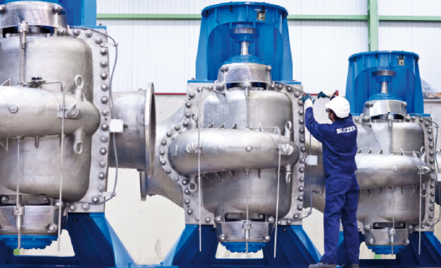

Centrifugal pumps are widely used in industrial and oil & gas applications. Courtesy of Sulzer.[/caption]
Centrifugal pumps are widely used in plants and facilities. They have one or multiple impellers. They are usually drive by electric motors although steam turbine-driven centrifugal pumps have been used in certain applications.
Horizontal pumps are usually more desirable than vertical pump configurations. But in some applications, special requirements such as low weight, compact configuration, and low net positive suction head (NPSH) might result in the selection of vertical pumps.
Centrifugal pumps usually receive less attention than they deserve. Most should have a positive inlet pressure to prevent cavitation, which is caused by lack of enough positive inlet pressure to prevent liquid vaporization.
