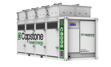

Capstone Green Energy and Microgrids 4 AI (MG4AI) unveiled their 800-volt direct-current (VDC) microturbine and engineered equipment package to power AI data center infrastructure. The Capstone 800 VDC natural gas-fired microturbine is designed to support MW-scale AI workloads and next-generation data center environments, leveraging its enhanced inverter-based power electronics technology.
“The evolving AI Factory design fundamentally challenges the energy delivery requirements and norms,” said Vince Canino, President & CEO of Capstone Green Energy. “Today’s AI racks already exceed 200 kW and are rapidly approaching 1 MW. Our 800 VDC microturbine is designed for this new reality, whilst building clean, reliable, redundant, and direct high-voltage power to the next generation of AI Factories.”
The 800 VDC unit can directly interface with the upcoming Kyber and Rubin Ultra platforms, and will eliminate multiple AC/DC conversion stages, reduce copper mass by up to 45%, and improve overall power efficiency by up to 5% compared to traditional 54V systems. The turbine will be integrated with MG4AI’s modular, liquid-cooled data center kits to establish grid-independent AI Power Blocks.
