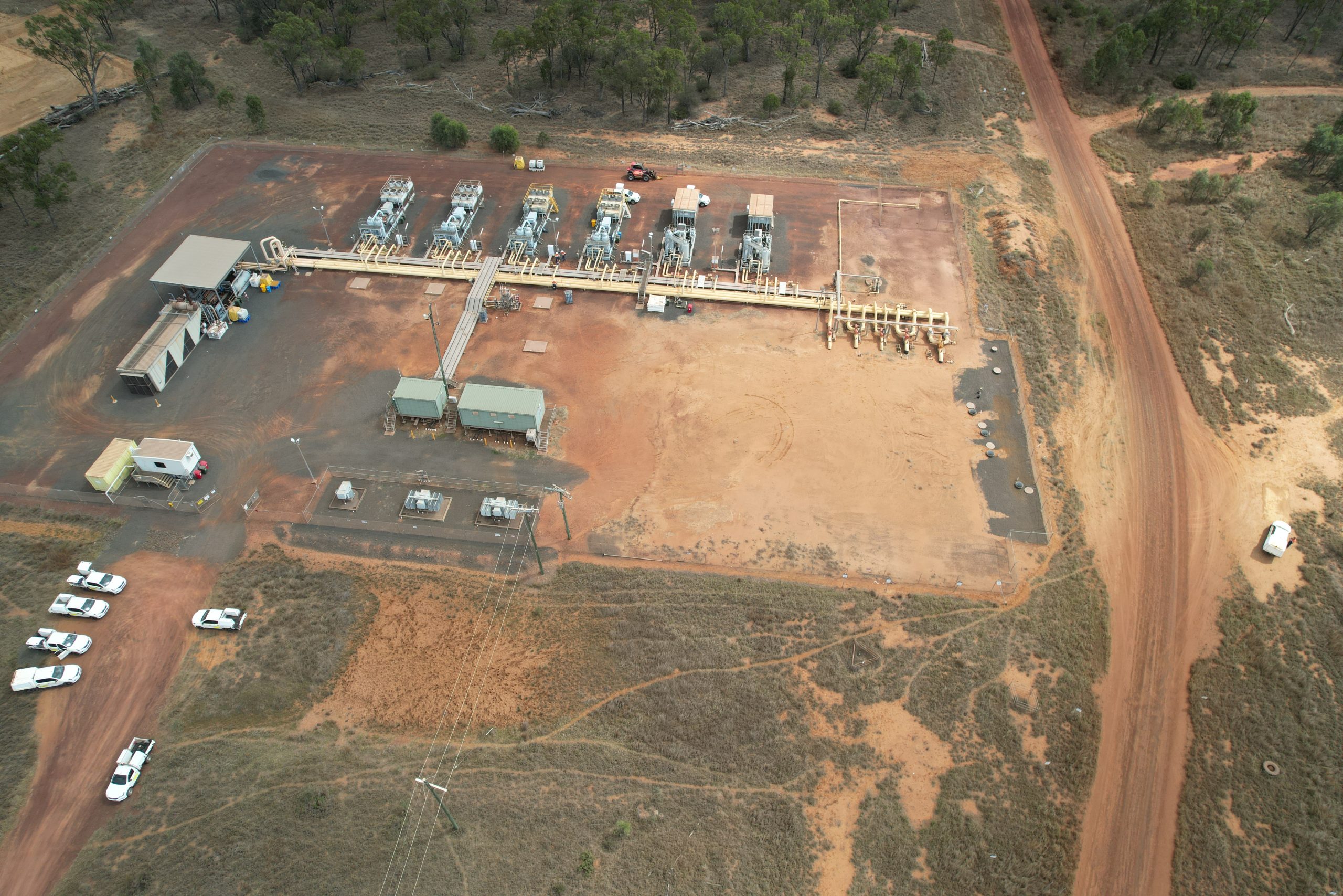

The LM6000 aeroderivative gas turbines, generating up to 112 MW for the Isaac Power Station, will allow QPM to expand the Moranbah gas production and infrastructure assets.
QPM Energy, an Australian gas producer and energy company, contracted GE Vernova to supply two LM6000 aeroderivative gas turbine packages for the Isaac Power Station, with commissioning scheduled for mid-2027. The turbine packages will generate up to 112 MW of electricity, allowing QPM to expand its Moranbah gas production and infrastructure assets—the Isaac Energy Hub.
“The development of the Isaac Power Station meets the State Government’s call for more gas-fired generation as flexible, gas-fired generation is essential for supporting grid stability during the energy transition,” said David Wrench, QPM Chief Executive Officer. “GE Vernova’s flexible units are anticipated to supply electricity during periods of peak demand. This daily peak generally arises after sunset, as solar generation decreases and households increase their energy usage for various activities.”
GE Vernova’s fuel-flexible aeroderivative gas turbines allow the plant to use QPM’s gas reserves and/or coal mine waste gas—containing at least 50% methane—collected during operation. The LM6000 is designed with high-cycling capability, providing power plant operators with the ability to start quickly and get on the grid. It can reach full power in approximately five minutes with a nominal ramp rate of around 30 MW/min, offering a fast primary frequency control response for improved grid support.
Also, LM6000 gas turbines are applicable to both peaking and baseload generation, in addition to grid firming operations, providing the flexibility to start and stop multiple times per day of required. With over 40 million operating hours and more than 1,300 units shipped, the LM6000 aeroderivative gas turbine operates in the 40 – 60 MW space.
“We are excited to contribute to the growth of QPM’s energy business, while supporting grid stability and reliability in Queensland as the state accelerates its transition to a more sustainable renewable powered future,” said Ramesh Singaram, President & CEO of GE Vernova's Gas Power Business for the Asia Pacific region.
