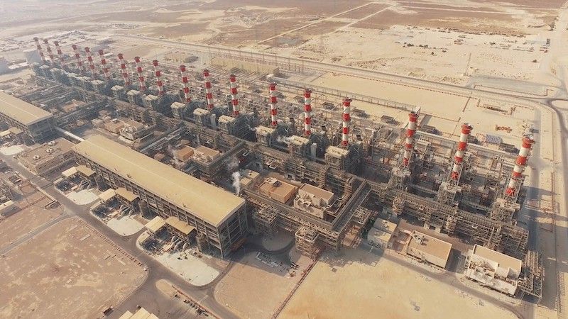

GE Vernova and the Ash Sharqiyah Operations & Maintenance Co. (ASHOMCo) completed front-end engineering design (FEED) studies at three cogeneration plants in Saudi Arabia, examining solutions to lower net carbon emissions. The company conducted a hydrogen-readiness assessment and an evaluation to improve performance and lower costs for the installation of carbon capture, utilization, and sequestration systems.

The plants are equipped with GE Vernova’s 7E and 7F gas turbines delivering up to 920 MW of combined power and 1,400 tons/hr of steam. This capacity is equivalent to the average electricity required for 920,000 Saudi homes.
