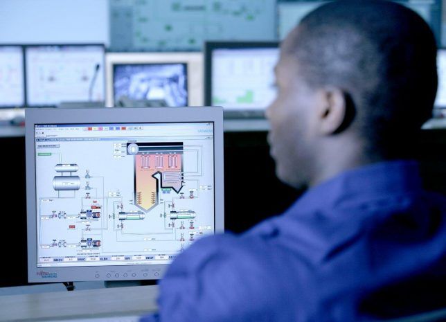

Siemens SPPA T3000 controls
Not so long ago, the turbomachinery controls marketplace was relatively stagnant. What a difference half a decade makes. Several trends are shaking the very foundation of the industry. They include greater use of wireless connectivity, digitization, retrofits, the cloud, data visualization, analytics, far more IT involvement, the vital necessity of employing cybersecurity safeguards, decentralization and the move to open systems. Wave after wave of IT technology and innovation are finding their way into plant control software. This is gradually bringing an end to a long-held separation between plant, turbomachinery and IT systems.
As these worlds collide, problems are inevitable — cybersecurity is one symptom of the initial teething troubles. The adventurous will boldly adopt the latest and greatest and bet the business on it. The cautious will wait in the sidelines to see how it all plays out. As to which strategy is correct, only time will tell. But if the retail sector is any sort of guideline, those late to the digital party may struggle to remain competitive. Companies, such as Rockwell Automation, Emerson Automation, Woodward, Tri-Sen, Elliott, EthosEnergy, MAN Diesel & Turbo, GE Oil and Gas, Siemens, MHPS, Petrotech, Solar Tur-bines, Energy Control Technologies and Schneider Electric are in the forefront of this revolution. Here is how they are adjusting to these trends and how they are gearing up for the future.

Siemens
The latest innovations to the Siemens SPPA-T3000 power plant control system are based on industry research. This uncovered the importance of the interface between people and machines in plant availability and reliability. Thus, Siemens has developed an operator- centric approach via a new Human Machine Interface (HMI). This covers prioritization of plant situations, being able to configure the workbench to user needs, and giving consideration to ergonomics to make it easy for system interaction. This includes intelligent alarm handling, which provides guidance to the operator in critical situations and workflow support for the daily routine.
Siemens also supports data applications running outside of the control system. This encompasses cloud apps, such as the Siemens Data and Security Gateway released last year. Dieter Fluck, Vice President of the Controls Technology Portfolio in the Power Services Division at Siemens, commented that the company has stepped up its efforts to ensure that plants and turbines are equipped with the latest security technologies. For example, Siemens has enlarged its IT security portfolio with application whitelisting which prevents the execution of unknown software and potential malware in the SPPA-T3000.
When it comes to controls upgrades, Fluck recommended that plants combine maintenance and turbomachinery upgrading with controls upgrades. Even though the control system upgrade is potentially a much smaller project compared to turbine maintenance, he said it can significantly contribute to an increase in availability, efficiency and start-up-reliability. “Consider reworking vintage turbine controls system with the aim to minimize mechanical and hydraulic components and move into electronic controls,” said Fluck. “Keeping current with the most recent upgrades, updates and patches is a mandatory security requirement.”
For those remaining on aging systems, Siemens supplies spare parts for systems older than two decades. It recently launched the extension of its service program for users operating the former TXP platform. But in most cases, control system operators have been moving to the most recent version of SPPA-T3000. Standardization To increase productivity in power generation, the company is investing heavily in digitalization. This implies the need for standardized communication and connectivity, and the ability to integrate with third-party systems based on common standards.
Additionally, the company has noticed a steady shift from large, centralized generation towards smaller, decentralized generation. “Turbomachinery control systems need to fit smaller generation units without losing the capability to handle increasing complexity,” said Fluck. “But they also need to be easily integrated into a whole energy system and managed as a fleet remotely.”
Siemens systems incorporate wireless technology. But the company is not seeing significant demand for wireless-enabled turbomachinery controls. Siemens added more digitalization to the latest release of its control system. For example, a software tool collects data from the controls system archive, as well as engineering data and data from edge devices, which is sent securely to the cloud. Cloud-based data analytic apps can then drive engineering optimization and operations performance enhancement of turbines and power plants.

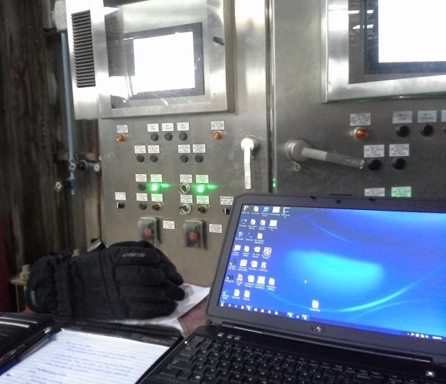

Elliott
The most critical need of Elliott customers is to run without interruption between scheduled shutdowns. Recent improvements to its controls address system availability via testable trip manifolds, partial stoke testing of turbine and expander trip valves, and improved system redundancies. “We must provide our customers with systems that are easily operated, maintained and understood,” said James Dugan, Controls Lead Engineer, Elliott.
Toward this goal, Elliott has developed more understandable HMIs and incorporated the implementation of PLC systems familiar to specific users, or project-specified, plant-wide distributed control system (DCS) hardware. The first Elliott PLC-based systems were installed in the mid-90s to the early 2000s. Some of these systems are approaching hardware obsolescence. The company informs users of the issues and offers possible solutions, such as newer replacement parts, or an upgrade path to a new hardware platform. Full system replacements, though, must be planned well in advance of shutdowns so that the application can be built and tested, and cabinet modifications can be well thought out. If the project is well planned, modifications can generally leave most of the existing wiring undisturbed, and system functionality can be thoroughly tested well before actual implementation.
“It is not a trivial task to remove an existing system, install the replacement, perform loop checks and acceptance testing, and commissioning, all within a period of a few weeks to meet the scheduled restart of production,” said Dugan. “But the cost of just one unplanned shutdown could pay for the upgrade.”
With the widespread adoption of IEC61511/ISA84 (a technical standard which sets out practices in the engineering of systems that ensure the safety of an industrial process through the use of instrumentation), he added, there is a focus on compliance. Under the SIS Safety Requirements Specification (SRS), these standards list the maximum allowable spurious trip rate for the functions of the safety system. However, any issue that will not allow you to run properly, such as a nuisance upset has the same impact as not being able to run at all. Even little things, such as the lack of field device redundancy, can jeopardize the productivity of critical plant processes all for the sake of an additional transmitter.
Historically, control system speed was the limiting factor in turbomachinery control implementation. This is becoming almost a non-issue, said Dugan, as the ever-increasing performance of computer hardware either enables more functionality or opens up other control system platforms for use. IEC61131 compliance allows for easy migration of proven logic into these platforms. “We have seen control systems (including compressor anti-surge, combustion and steam turbine control) implemented within various DCS platforms (800xA, C300, DeltaV) long considered too slow for this sort of application,” said Dugan. “Our customers are also requesting security features, such as hardware-based industrial protocol firewalls, and the implementation of least privilege security strategies.”
Elliott sees a role for wireless solutions where connectivity is a problem. As such, wireless is more likely to be used in a system modification rather than a new installation. That said, wireless may not be ideal where runtime is to be maximized and the spurious trip rate is to be kept at a minimum, noted Dugan.
