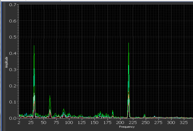

Numerous factors can impact the aerodynamic and mechanical behavior of turbomachinery and the selection process for Type 1 or Type 2 tests. These mostly relate directly or indirectly to the higher pressure and aerodynamic loading experienced on the Type 1 test. Primary among these are deflections or relative movement of parts. As a result, there can be subtle differences in the primary and secondary flow path geometries under Type 1 and Type 2 test conditions.
For example, one of the most common geometric changes that might occur during a Type 1 test (but not under Type 2 test conditions) is bundle deflection due to manufacturing tolerance stack-up. In a typical re-injection compressor, the highest pressure occurs in the last-stage diffusers (for both straight-through and back-to-back arrangements). Thus, forces on the sidewalls of the last-stage diffuser will cause the diffuser walls to move apart. As the last-stage diffuser is also typically the narrowest in a compressor, its behavior is more sensitive to axial deflections.
The amount of deflection depends on the machining tolerances of the bundle components and the fits, as well as material deflections that might occur from pressure forces or thermal effects. Typically, maximum deflections are in the tens of thousandths of inches (or tenths of millimeters) and of little consequence in most compressors.
However, if the design diffuser width is narrow (often the case with high-pressure reinjection compressors), tens of thousandths of inches can be a large percentage of the diffuser width. It is possible for the width to increase sufficiently for diffuser rotating stall to occur, resulting in high levels of subsynchronous radial vibrations. This probably would not be evident during a lower pressure Type 2 test. In one instance, had a Type 1 test not been run at the OEM facility, this exact problem would not have been discovered until the compressor came on-line in the field. The significant warranty implications to the OEM and lost revenue to the end user due to production disruptions would likely dwarf the cost of a Type 1 test. It is advisable, then, that end users, process engineers, and OEMs discuss compressor testing at the OEM’s facility to address aero-mechanical concerns prior to shipping equipment to the site. ■
