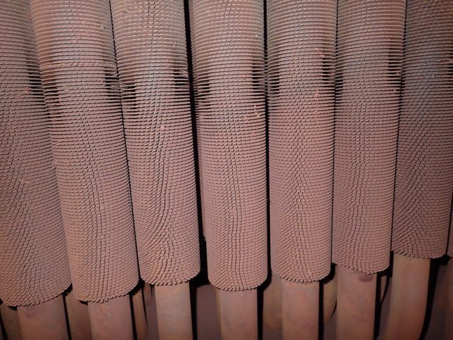

HRSGs can suffer from a variety of problems including rust, build up of oxide, exfoliation and tube failure

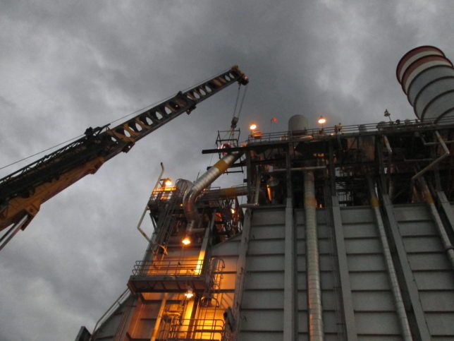

Installation of failed re-heater piping on HRSG
