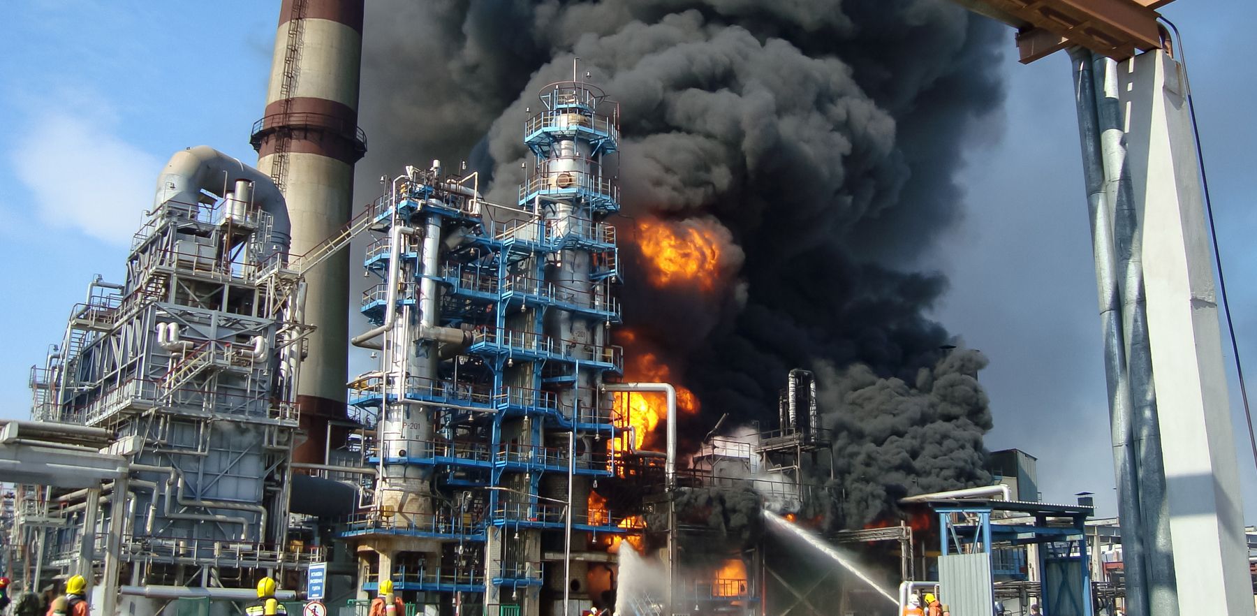

EO is both flammable and highly reactive under ambient conditions. This highly reactive nature is one of the main reasons why EO is such a versatile and important chemical intermediate. The tendency to react readily with other chemicals is also what presents many hazards, such as explosions. Some examples include an EO explosion at a chemical factory in Spain in 2020, which was powerful enough to propel a one-ton steel plate nearly two miles, where it crashed into an apartment building. About a decade ago, a chamber containing 100 pounds of the gas detonated, launching two-ton metal door 75 feet away which injured four workers at a sterilization facility in the US.

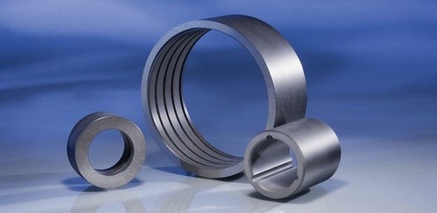

Eliminate Bearing Swell Issues and Improve Pump Efficiency
Due to the explosive nature and critical safety concerns with EO, several chemical manufacturers utilize custom designed seal-less, canned-motor pumps. Chemically aggressive media, such as EO can attack traditional bearing and seal materials.
That was the case at a major chemical processing plant in Germany that produces EO. The specialty chemicals’ company uses canned motor pumps produced by HERMETIC-Pumpen GmbH, known for their safe and durable pumps under the most extreme applications and in the most hazardous pumped media. These pumps contained carbon-fibre filled PEEK bearings that were swelling in EO media. The excessive swelling of the bearings resulted in unreliable pump operation, reducing Mean Time Between Failures (MTBF) to a month and sometimes a week.
They reached out to Greene Tweed in search of a new bearing material to handle the harsh processing conditions of the EO service. The recommendation was replacing the carbon-filled PEEK bearings with WR 600 bearings, a carbon-fibre-reinforced, PFA-based composite with a maximum continuous service temperature of 500°F (260°C). Its chemical resistance comes from its constituents, which can withstand virtually all environments, including the strongest acids, bases, halogens, and solvents.WR 600 is a non-galling/non-seizing composite material, which allows the bearings to be designed with tight clearances, leading to improved efficiency and longer life.As a result of changing the pump bearings to WR 600, the chemical plant extended their MTBF from a few weeks to over two years and counting. Encouraged by the results, the chemical plant has specified WR 600 on all onsite Hermetic pumps in EO service.
