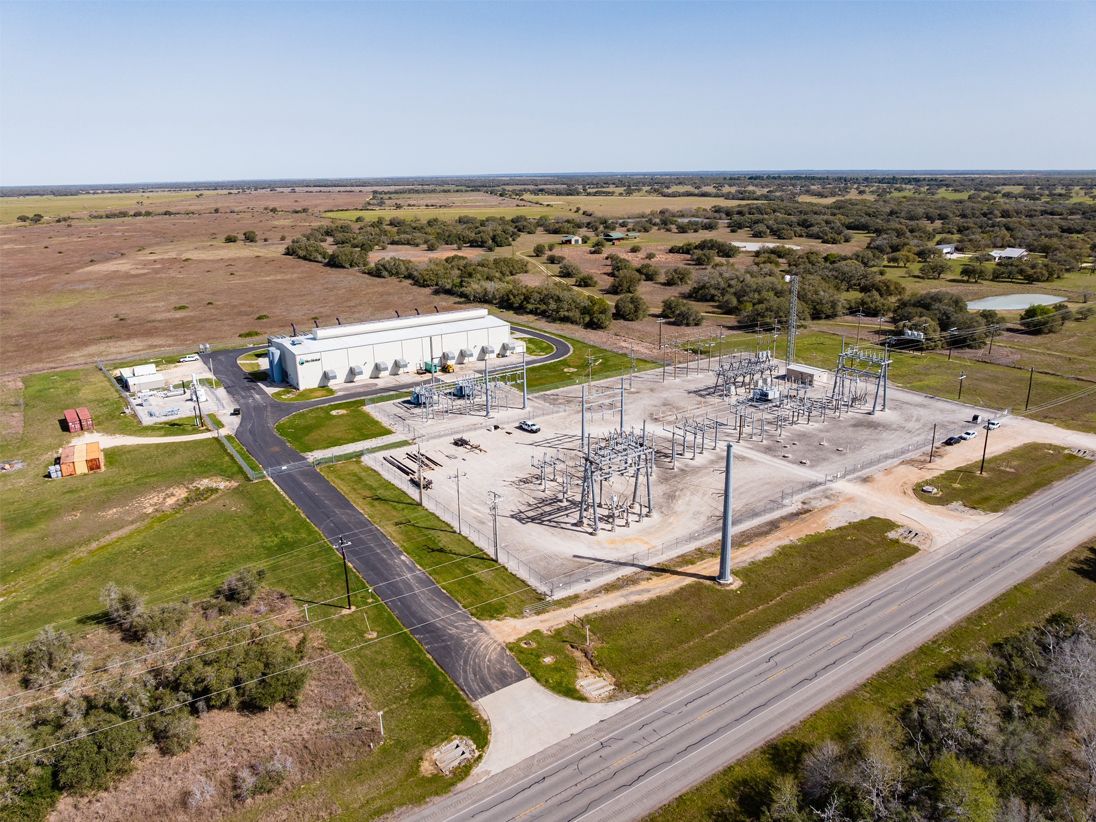

KPUB’s future power generation facility will be constructed adjacent to the Sky Global Power One in Colorado County, Texas, leveraging existing infrastructure and a proven operational location.
KPUB’s future power generation facility will be constructed adjacent to the Sky Global Power One in Colorado County, Texas, leveraging existing infrastructure and a proven operational location. Credit: MAN Energy Solutions
