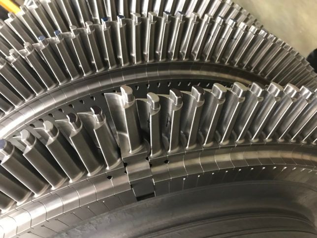

Upgrading turbine blades
Steam turbine blades can fall victim to a variety of damage mechanisms from high temperature creep to erosion, fatigue and stress corrosion cracking. Boosting blade reliability is paramount when repairing a steam turbine. A complete engineering reevaluation of blade design is recommended if a failure has occurred or the turbine’s operating speed has changed.
Such evaluation includes a structural and modal analysis by means of finite-element analysis (FEA) software tools. It provides an insight about stresses in the critical areas (blade root, fillets, shroud) and natural frequencies of the blade that can be excited by the passing frequencies of stationary vanes at a certain running speed. This can cause resonance.
Based on the analysis, recommendations can be made to change the blade or locking hardware material or redesign the root. Resonance issues can be solved by avoiding the speeds of concern, modifying an airfoil or a shroud redesign to shift its frequencies and increase damping.
Upgraded blading provides both efficiency and reliability improvements, which can be further enhanced by the application of protective coatings to extend their life.
