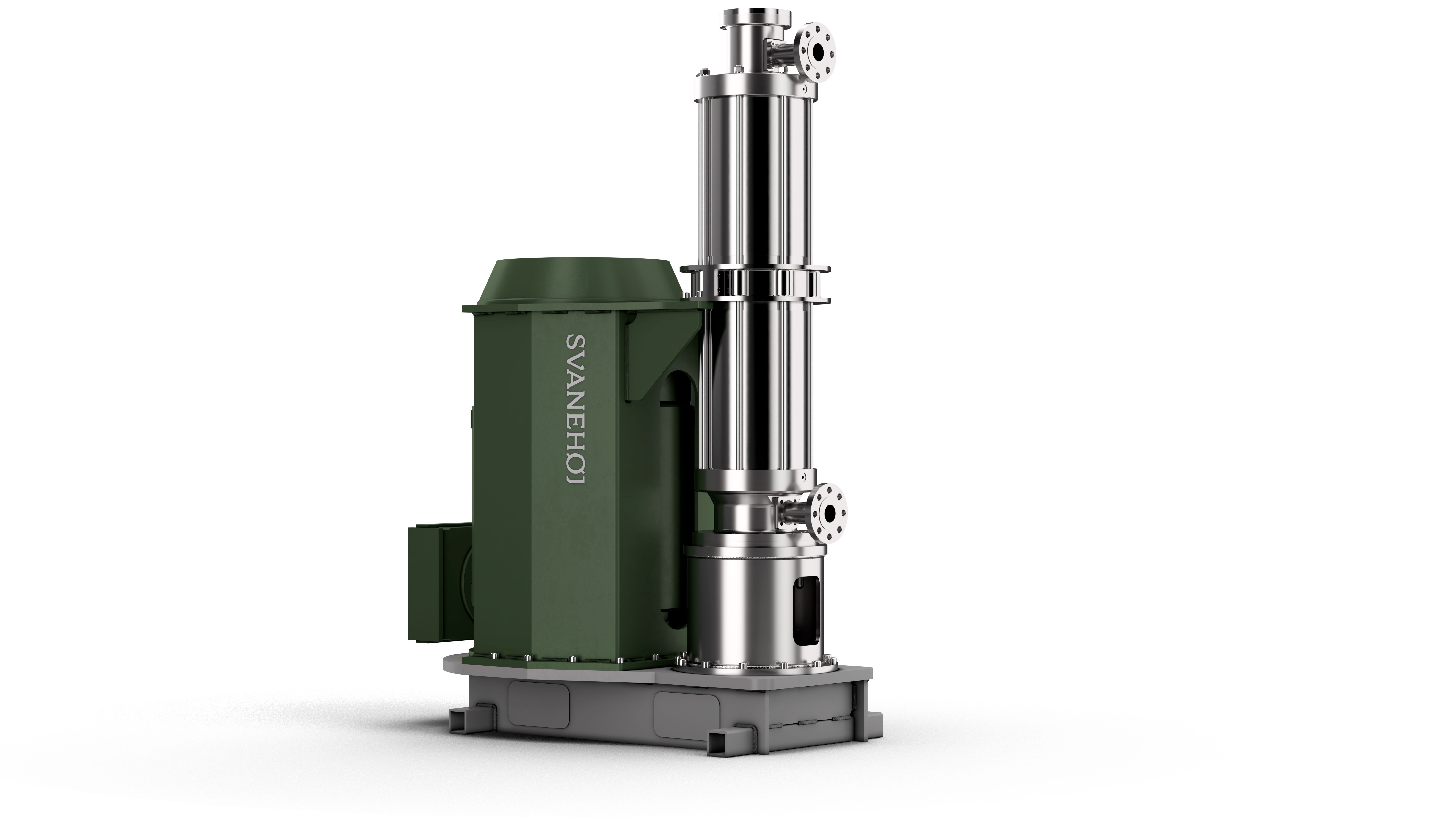

Svanehøj developed a dedicated high-pressure ammonia fuel pump, the HP NH3 Fuel Pump, capable of fuel injection pressure up to 100 BAR. It is based on the company’s deepwell low-pressure fuel pump, some of which are used for marine-based ammonia fuel applications. The HP NH3 Fuel Pump has a small footprint—2,100 x 780 x 1,450 mm—and can fit the tank connection space (TCS) in an ammonia fuel supply system.
"We have long been encouraged by customers and partners to develop a high-pressure ammonia pump of the same standard as our low-pressure fuel pump,” said Johnny Houmann, Chief Sales Officer at Svanehøj. “Early in the R&D process, we determined that our existing centrifugal pump design would be the optimal solution in terms of efficiency and maintenance. As a result, we have developed a pump with a design that already has a proven track record, and we are confident it will meet our customers' high expectations."
Accounting for ammonia’s highly toxic and corrosive properties, Svanehøj introduced the following features:
  • Hermetically sealed with no mechanical shaft seals
  • Magnetic coupling to ensure torque transmission from the motor
  • Containment shroud made of magnesium-stabilized zirconium oxide to keep temperature stable
  • Optional fail-safe mechanism to contain pumped media within the coupling housing
“Although no commercial ships are operating on ammonia fuel yet, the maritime market has shown a growing appetite for investing in green ammonia solutions,” said Houmann. “Ammonia-fueled ship engines will be commercially available by 2025, and at Svanehøj, we are proud to support the energy transition of shipping by offering both low- and high-pressure pump solutions for the emerging green ammonia market.”
For maintenance operations, the pump is fully drainable and can be lifted out in one piece. It contains a media-lubricated, easily changeable ceramic ball bearing for axial loads. In terms of power transmission, Svanehøj uses a heavy-duty drive with a carbon-reinforced, accessible timing belt system. The HP NH3 Fuel Pump has flow measured at 37 m3/h and a discharge pressure of 85 BAR.
