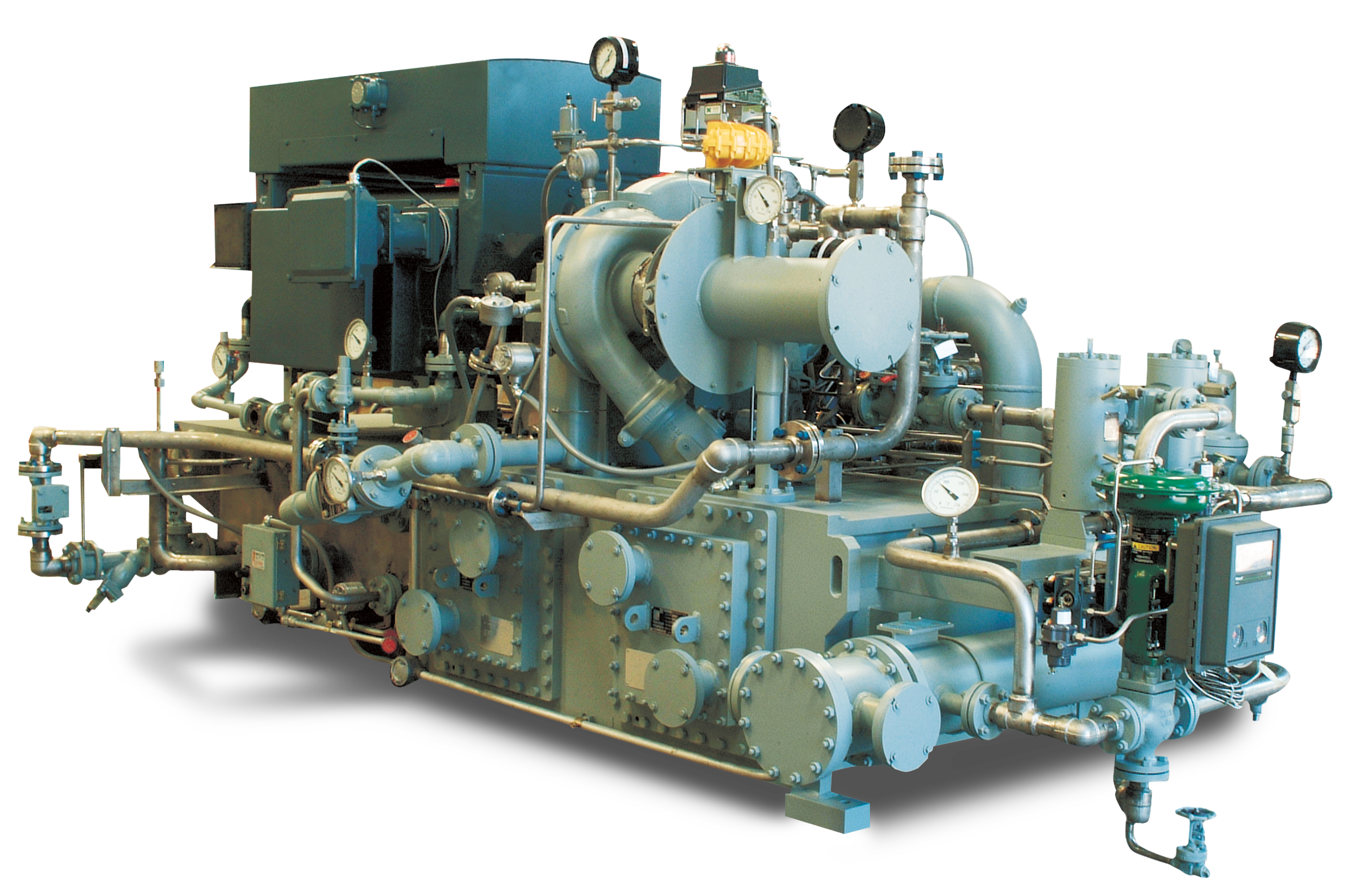

FS-Elliott has two compressor product lines, the Polaris+ and the PAP Plus. Polaris+ air compressors serve customers in industries such as food and beverage, textiles, industrial manufacturing, plastics, and power generation. The PAP Plus line is mostly utilized in oil refining, petrochemical, and LNG production and transport. It offers compliance to API 672 and API 614 standards. The company is also active in the air separation industry, where both of its compressor lines are used.
The PAP Plus A1 is FS-Elliott’s workhorse compressor for oil and gas. Primarily used as an instrument air compressor, the A1 is available in cost and short lead-time pre-engineered configurations to meet API 672/614 with critical reliability features. The A1 can be customized to meet specific requirements to ensure year-round reliability and operation.

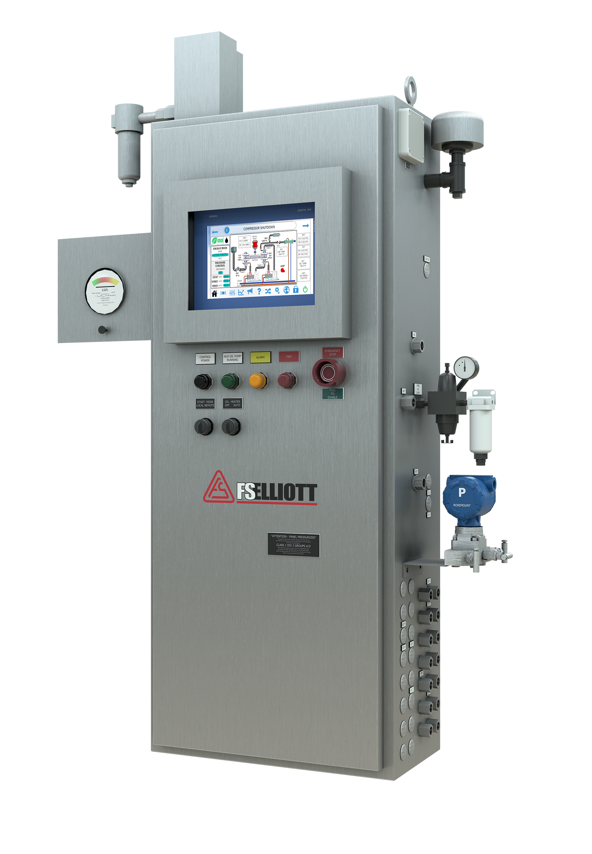

FS-Elliott offers a range of control systems, including both microprocessor-based and PLC solutions. Its control panels support needs ranging from a basic user wanting to turn the compressor on and let it run without worry to more complex solutions encompassing redundancy and monitoring of every characteristic of compressor operations.
The new FS-Elliott R2000 control panel features improved energy efficiency and a better user experience while reducing downtime. On the energy savings front, an Energy Advisor makes suggestions to improve efficiency based on operating trends. Its maintenance notification system tracks compressor usage and provides predictive maintenance advice.
