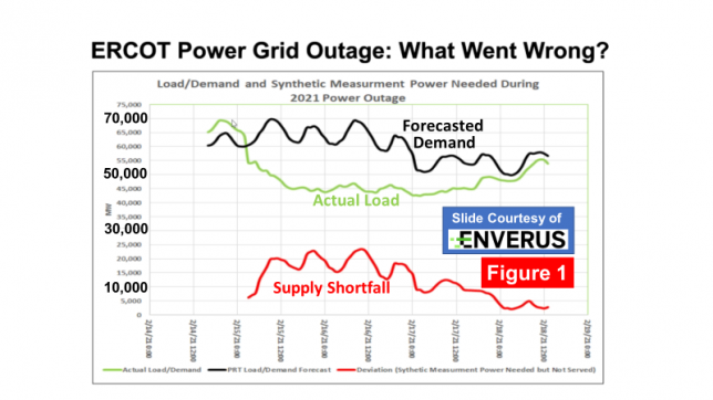

During the next three days, supply did not come close to meeting demand. The shortfall exceeded 20,000 MW at times. By Thursday, some of the forced outages at generation plants had been resolved. Higher temperatures enabled the rolling blackouts to be shortened or eliminated. Power had been fully restored to most customers by Friday 19 Feb except a few isolated areas where had damaged distribution lines.

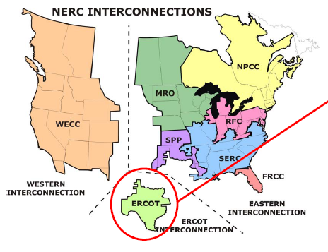

The Texas grid does not fall under the authority of the Federal Energy Regulatory Commission. Most Texans like it that way. Feds in Washington D.C. don’t. This wiring diagram was created during World War II as protection from any event that could possibly take down the electric grid of the entire country.
After the storm, some floated the notion that if ERCOT had been electrically connected to the Eastern and Western grids, power could have been imported to avoid blackouts. This is false. The regions of the grids adjacent to ERCOT were also affected by the storm. They incurred shortages of natural gas and rolling blackouts. There would have been no power available to import.
