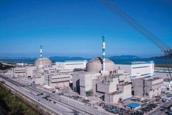

Every two years, nuclear customer Cofrentes (Iberdrola) has a planned outage to refuel the reactor and maintain the plant. The customer is one of the largest nuclear PP (1X 1102MW) power provider in Spain near Valencia, originally commissioned in 1984. For reference, a power plant producing 1,000+ MW can provide power tomore than 1 million homes.
A few weeks before the regularly scheduled service, the team could not mobilize due to the risk of COVID-19, and the travel restrictions existing in Spain at the time.
