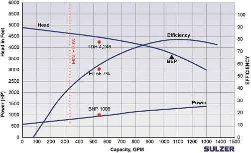

In the following example, one boiler feedwater pump (BFP) was selected from a group of eight where proactive field performance testing was accomplished. Performance testing was employed to provide the owner/operator with quantifiable pump condition data to aid in prioritizing unit overhaul schedules. This particular generation facility is configured with six separate combined-cycle units employing 12 feed water pumps. The example pump is one of eight axial-split, multi-stage, ring-section pumps. At the time of field performance testing, gross facility generation was limited by ISO dispatch to 60 percent of full generator / heat recovery steam generator (HRSG) load.
Figure 1: Pump actual operating point, flow limited to 58% of design point.[/caption]
Figure 1 shows pump hydraulic performance “as found”. Note how far to the left of best efficiency point (BEP), shown in blue, test results, shown in red, fall on the original equipment manufacturer (OEM) test curve. Critical pump operation is expected to fall within 70-120% of BEP. In this case, although test results fall directly on the test curve indicating satisfactory performance, subject pump hydraulic results show operation at 58% of BEP. This is a surprisingly common situation in the current generation market.
In addition, in cases where the pump’s NPSHr curve rises with a reduction in capacity, the NPSHa may be insufficient to overcome the on-set of cavitation. Operation at lower than recommended BEP flows can result in pump inlet flow recirculation leading to increased vibration, wear and reduction in mean-time-between-repairs (MTBR).

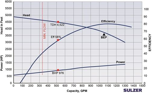

Example 2 considers the same group of eight pumps as considered in example one. By prioritizing time-based overhaul scheduling founded on actual unit performance, the owner/operator can maximize unit reliability and availability.
Figure 2: BFP C1 – Hydraulic results indicating increased clearances.[/caption]
Figure 2 shows boiler feedwater pump (BFP) C1 hydraulic performance results which are indicative of degraded or less than optimal internal clearances. Note that results fall below the OEM test curve indicating unsatisfactory performance and that flow capacity is limited to 51% of BEP.

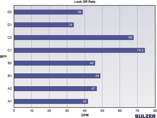

Balance line leak-off rate is an excellent and well-documented indicator of internal wear. Figure 3 graphically tabulates leak-off rates of the eight subject pumps and, as expected, the largest flow rate recorded was at BFP C1.
Figure 3: Balance Line Leak off Comparison[/caption]
Pump mechanical integrity is also evaluated in addition to hydraulic testing with real-time vibration data being captured and analyzed. BFP C1 vibration response showed clear indication recirculation at the suction side and BFP C2 exhibited similar response to a lesser degree. Vibration data were consistent with pump hydraulic results and leak-off rates. The facility prioritized overhaul scheduling accordingly.
